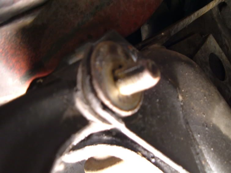

Any tips on how to get the RUCA bolt out? It is the one more towards the gas tank, the one I think that is used for adjusting camber in the rear. I got the nut off but the bolt just will not come out.
Im hitting it with a hammer jamming a screwdriver in there and nothing

the eccentric bolt slipped and is not lined up proper w/ the bolt. the bolt has a valley running along it. the ecentric bolt has a little point that should go into tha valley
you need to lie them up again and then you canslide bolt out
i sugged putting the nut back on and usinga breaker bar on the head of the bolt until the point lines back into the valley
then remove the nut and hit the bolt out w/ a hammer
been there donethat. just takes a bi tof time and patience and it willpop right out.

wow just relized the bolt is stuck on there good. The washer on the opposite side has moved out of its groove and is on the something whatever look at the pic wish me luck getting this off
You can kinda see it here the thing isnt in the groove

see my post you ll have it fixed real fast like

Thanks guys I actually used some vice grips and turned the head of the bolt till it lined up. Got it off nice and easy

Did exactly what dousan said. It works. Perfect.
But haha I kinda stripped the bolt thread cause I turned it so many times. But whatever, it works. DONE.

Use Dousan's way, its the right way. just turn the other side of the bolt until it lines up with the valley so it can come out or else no amount of penetrating lube with help. Just turn the bolt and the washer will nudge up against the subframe so that you can torque it. Just look at how the bolt is shaped and how the washer is shaped and figure it out. This happened to me and it took 2 seconds to see what was going on. I trust you can do that same. Good Luck.
