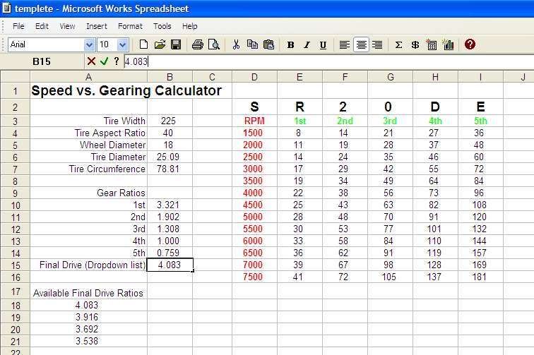

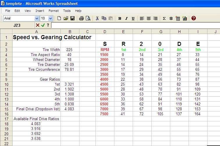

Its true the KA has a 0.759 5th ratio vs the SR .0.838 ratio:
SR20 tranny with 0.838 5th gear ratio:
KA24 tranny with 0.759 5th gear ratio:
