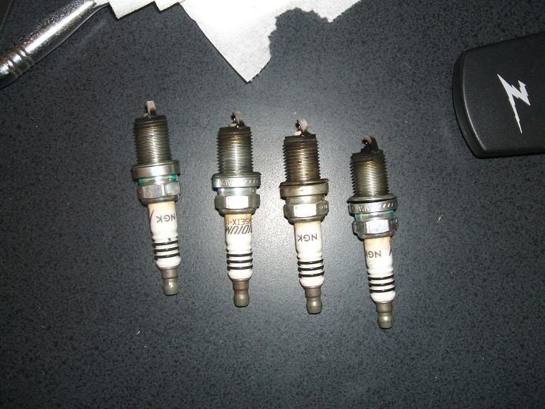

Alright performed a compression test just now. and these are the readings. 150-145-145-150 Pulled my spark plugs. (I replaced them 2 weeks ago along with my oil change. [Cold weather means Heat range 7 plugs with 10W-30 full synthetic oil] and they are fouled)
So perhaps my MAF took a shit on me. now to test the MAf. ehhh.. my pc crashed and I dun got adobe acrobat. what should the MAF voltage be at idle?
