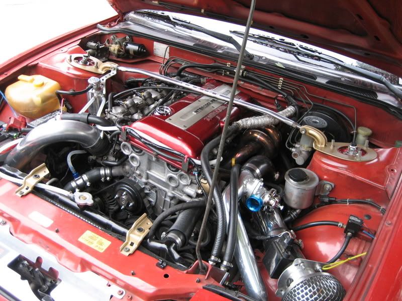

Looking at your pic it's hard to see if you have the lines run correctly. The drain back is a little high. Can you post more pics of your set up?

and heres a pic, the drain back is connected to the bottom nipple, it just looked like it was goin to one of the upper ones in the first pic..

damn, thats a pretty clean engine bay...hella monica gellar status...
