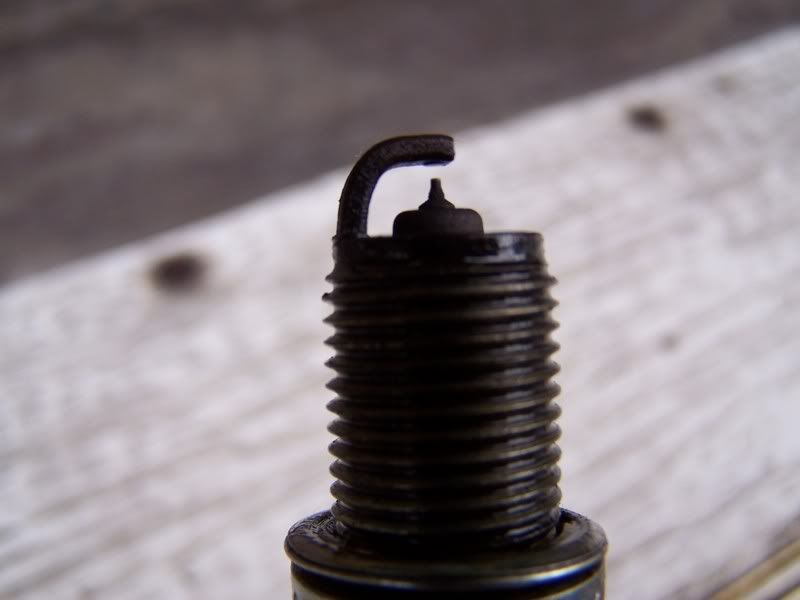

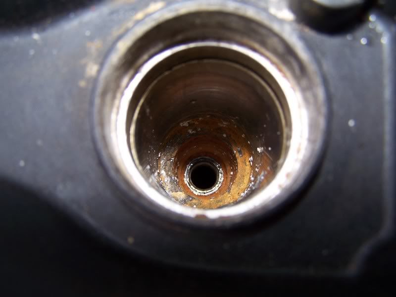

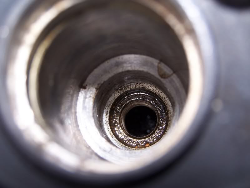

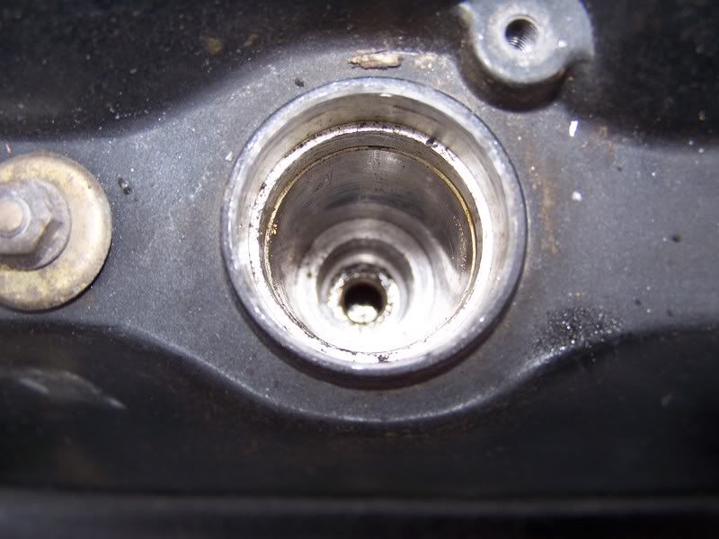

Here are pics of the spark plug holes.
CYL #1
CYL #2
CYL #3
CYL #4
Spark plugs
