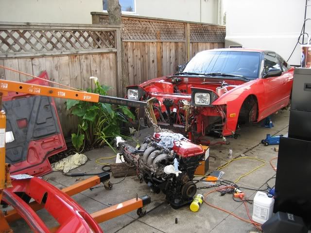

so here is whats going on.
before the rebuild
<a href="http://img204.imageshack.us/my.php?image=b4yj6.jpg" target="_blank"><img src="http://img204.imageshack.us/img204/4467/b4yj6.th.jpg" border="0" alt="Free Image Hosting at www.ImageShack.us" /></a>
after the rebuild, then it blew at 2600 mines, damn waterpump
<a href="http://img256.imageshack.us/my.php?image=afterdv2.jpg" target="_blank"><img src="http://img256.imageshack.us/img256/5959/afterdv2.th.jpg" border="0" alt="Free Image Hosting at www.ImageShack.us" /></a>

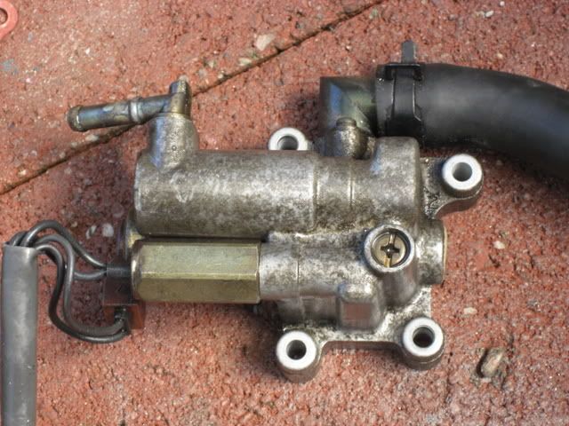

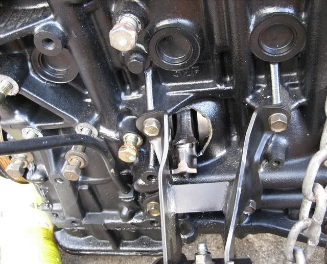

ok here are some pics that worked. and i was looking at the painless whireing kits, BAD ASS! i might do that in the fiture not on this 240 but deff on my next one i buy.
before the rebuild.
after the rebuild, ya 2600miles then my clutch fan shattered and broke my waterpump and boom. what ever.
And now
q45 upgrade. and new pulleys just for fun. repainted and rebuilt alternator. and powersteering pump.

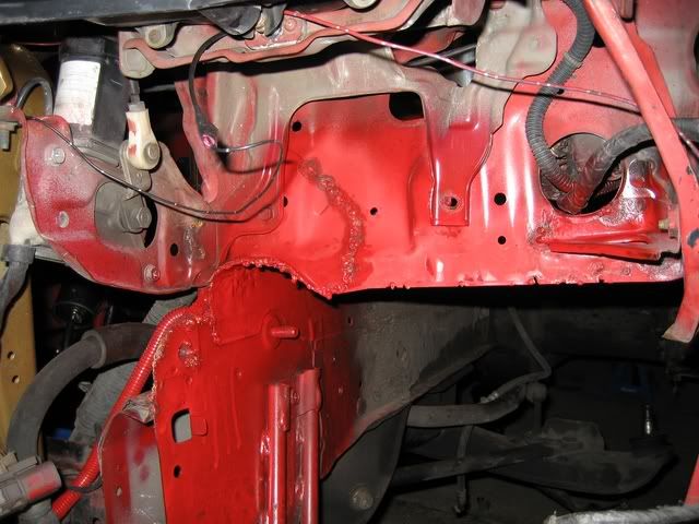

Crapy bird shit welding, wire was like 10 years old and ran out of gas. so im gona buy some gas and new wire after i get back from austraila next month.

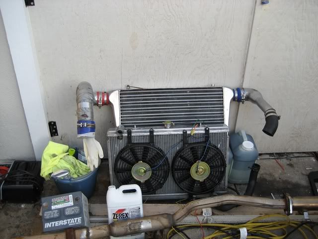

rad and intercooler

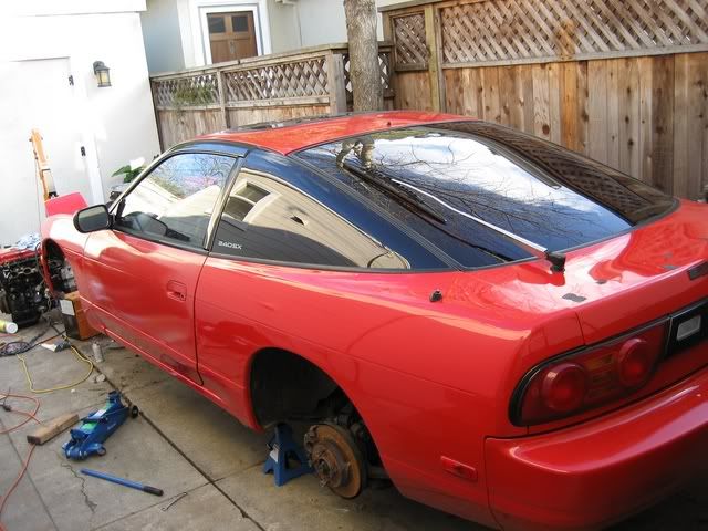

hay back from australia some crazy nissans. and came back and the firsh thing i did was unpack and called my friends and pet my car. yep i pet it. like rub... anyways i had a bbq with friends and worked on my car some more. i took the fenders off and moved some wires and hammered out some stuff. frames a tiny bit bent so i hammered it a little and im gona go pick my friends welder later today. and go at it. pic time!

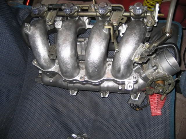

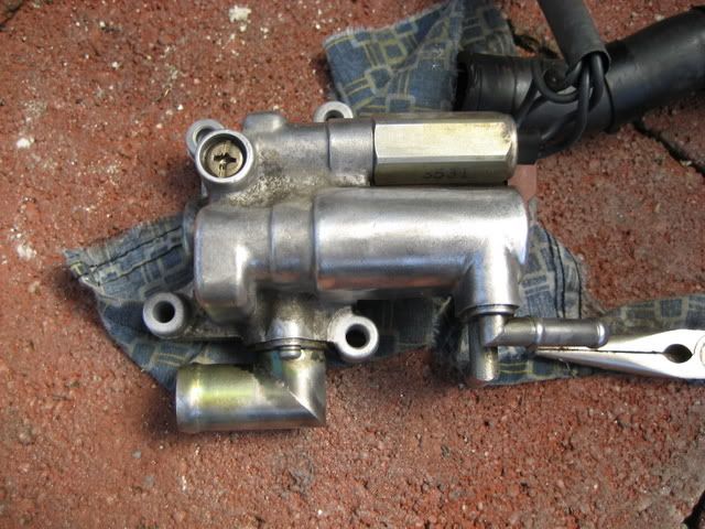

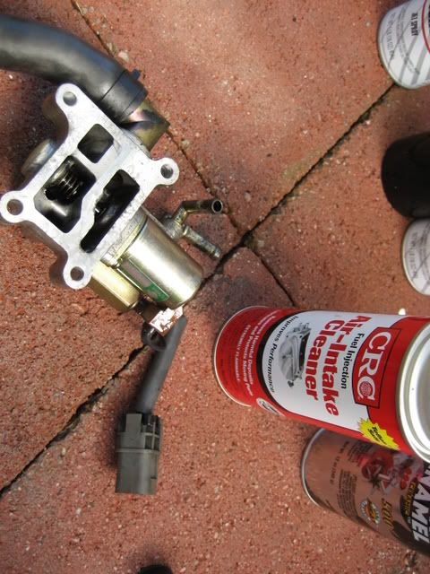

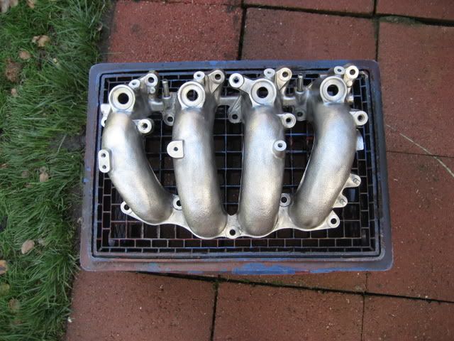

well i finished welding and painting today. also polished my intake and fuel injecter covers. cleaned out my IACV and put on a new gasket. and started bolting stuff back on.
