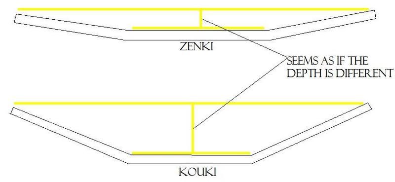

So i read the excellent writeup by simple s14, and it answered almost all of my questions... But i still have a problem or two
1. Aside fron the grille brackets, how else do the zenki and kouki retainers differ... BECAUSE, when i tried to set the kouki headlight on the zenki retainer... it wouldnt sit "in" the pocket behind the retainer... ALSO, the bottom of the zenki light is flush whereas the kouki bottom is not flus hand pertrudes downward to hit the zenki retainer, but from pics, it doesnt look like the kouki bracket offers any more clearance for the underside of the headlight... So whats the deal???
2. is the kouki bumper reinforcement absolutely necesarry
3. Finally, as far as width is concerned... i mounted up the kouki hood onto the ALL zenki front end and the fenders were to close (Ie- the hood overlapped the zenki fenders/fitment on both sides)... So my Q is, do the kouki fenders need to be spaced further than the zenkis to clear the new wider kouk hood, or is my shit just jacked?

also, could someone please (since my car is 30 miles away) measure the zenki hood and the kouki hood at the same corner point near the headlights? the width please?

nono, im sorry, i am converting to kouki, BUT i put jsut the kouki hood on to center it between the zenki fenders, and work fro mthere as to be aligned correctly, BUT the hood overlapped the fenders on both sides.
i understand the purpose and use of the support and reinforcement, im going to be using both, but i was wonderign if there were clearance or agnular differences i nthe s14 kouki and zenki (black bar) retainers.. because the bottom of the zenki headlight is flat, whereas the bottom of the kouki is not

In all simplicity, i think we are not connecting on the right points here. All im asking, is if aside fro mthe mounting points, is the kouki bumper reinforcement shaped differently... here, let me make a diagram..
so what im trying to figure out, is if this is natural, or i have a bigger problem.
and my point with the kouki hood overlapping was that i think the whole kouki front end is about 2 inches wider than the zenki, and if it is, im in luck, and not fucked. But basically, i was starting the conversion, but soon after got worried and stopped..

Of course the Kouki hood is wider, we all know this. You can even look at the tops of the Kouki fenders and see they flare out while the Zenki fenders are completely flat against the hood's edge. That alone answers that question, something you could have done visually in ten seconds.
The bumper support brackets are longer on the Kouki, again something you can see visually just by looking at it. The Kouki's nose is longer, how would it account for that if the support was the same length? The upper retainer is different as well since it bolts to the support at an angle, while on the Zenki support it's straight.

If you look in these pics, I have kouki fenders on, and a zenki hood. The kouki hood is about 2-3 inches wider at the front and middle than the zenki.
This is the reason why your kouki hood is overlapping your zenki fenders.
You also need to change the bumper support to the kouki one, do not try to salvage and force the zenki one to fit. Devonkyle77 or somethin has one for sale dont cheap out and just buy the right parts.
Hope this helps

Problem here is I believe you are confusing yourself bet. bumper reinforcement and retainer/support.
The zenki reinforcement can be made to fit the kouki front end, while on the other hand the retainer/support will not be able to work with the mounting points, they are all misaligned which i believe your drawing states.
