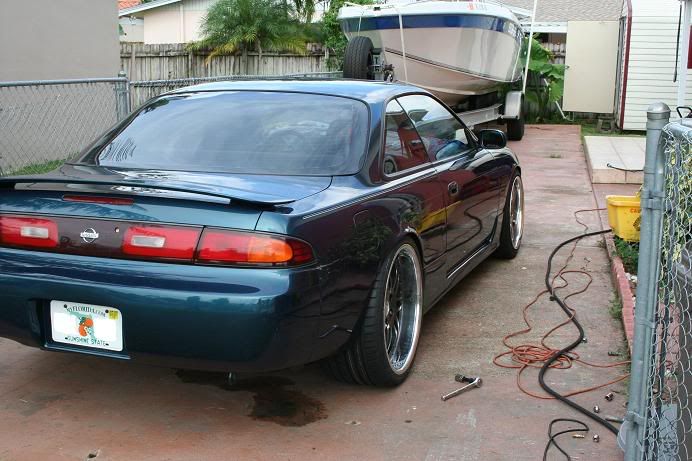

Here's gsracer's car test fitting another friends 20" iforged. i think they're 20x11 +45 with a 10mm spacer...making it an effective +35 to clear the coils.

those sizes are pretty useless without offsets.... Like my previous post shows and others said, try them on and see for yourself. It really depends on what type of suspension you're running, fender pull, offsets, etc....
They wont fit very easily, but its definitely doable.
AAANNND, twankies dont look right on S14's imo. I wouldnt bother...
