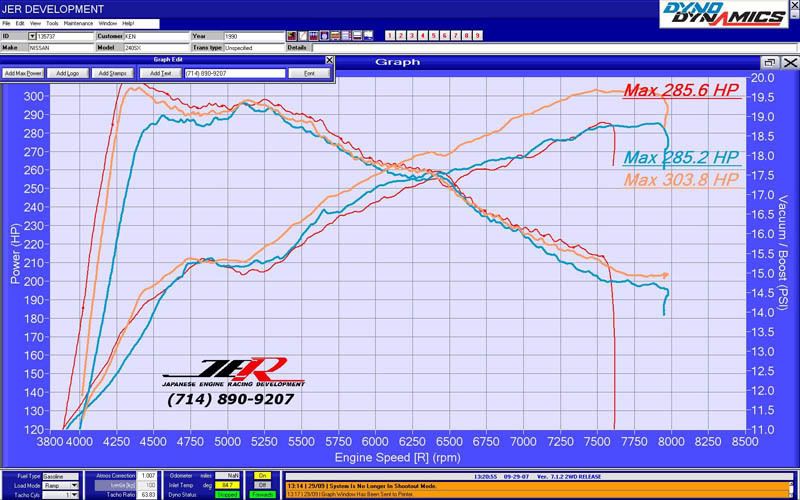

Went for a dyno pull this weekend and thought I'd share as people are always interested in seeing dyno sheets. The dyno was done over at JER in Westminster - Linh who did my pull was really friendly/knowledgeable.

The dyno was done on a dyno dynamic. The first pull was the best netting 303hp - after that something was acting funny and started losing power even after a cool down. You can see the boost was dropping off quite a bit towards the end - time for a EBC.
I'll start diagnosing once I get the datalogit in. The car was spitting up quite a bit of oil through the BOV making me worry that it may be rings or turbo that's going.
enjoy.

what psi was this done at?

PSI shown on the graph - around 19-22 dropping off to 15.

I just did 390 whp yesterday on dynodynamics at 17 psi on 91 oct.
AFR is still like 10:1
its a great dyno, usually 16% lower readout than dynojet.
...are you sure he didnt have something corrected on the first run, then fixed it and the second two are actually your legit numbers?
just a thought...
because thats a screen shot and not a printout we cant see what parameters were input.
either way decent numbers for that dyno
just a thought...
390hp - very nice. Yea, i'm already wanting more..
No correction from the first run - he wasn't quite sure why the last runs were lower. I actually upped the boost a lil on the last run and still made same numbers.

maybe the missing part is me tuning it haha
cheers man. youll get there.
you pulled your revs out pretty high I see for peak
I think I stopped at 7300 on mine power was still climbing.
-what duration cams? 256?

So I got the Datalogit installed and I happen to notice that one of the settings, ignition vs. airtemp, showed that at 50C it would retard ign. by 3 degrees. Could 3 degrees be enough to lose 18rwhp?
That brings me to another question - I recently moved the air temp sensor from the intake piping into the manifold. When it was in the piping, the temp was in the ambient-40s, in the manifold, it ranges 40s-60s. In the manifold is where Apexi suggest although it seems like the manifold is absorbing a lot of heat. Just idling for a prolong amount of time on a cool day is enough to raise it over 50. On a warm day it will go over 60.
The piping on the cold side is still cool to the touch, so the air is actually much cooler than the temp sensor indicates. Is this normal and is there any adverse effects to raising the ign retard setting to 60 or 70?
Blues13 is offline   Reply With Quote
