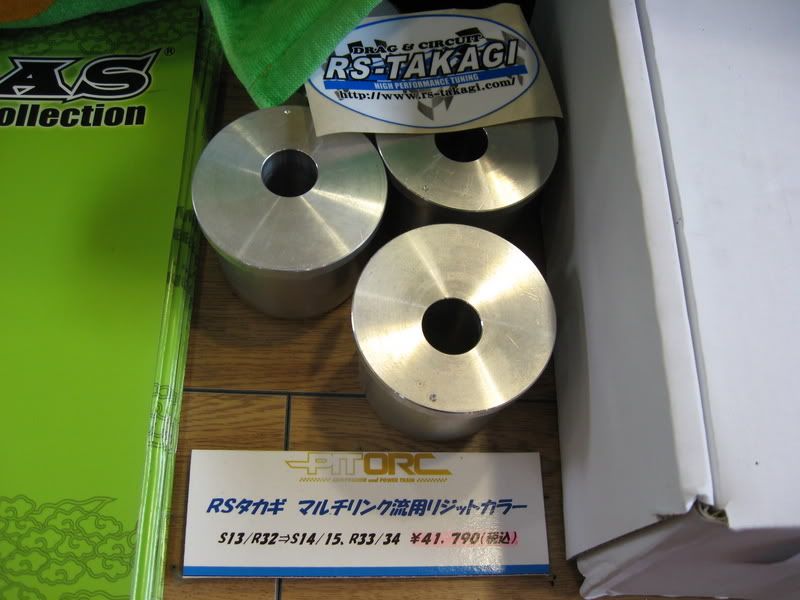

yeah offset bushings are PRICEY!!
i had the subframe as said above
