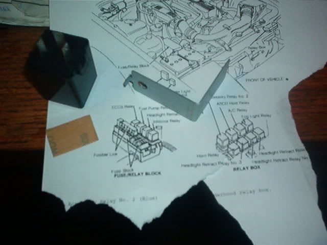

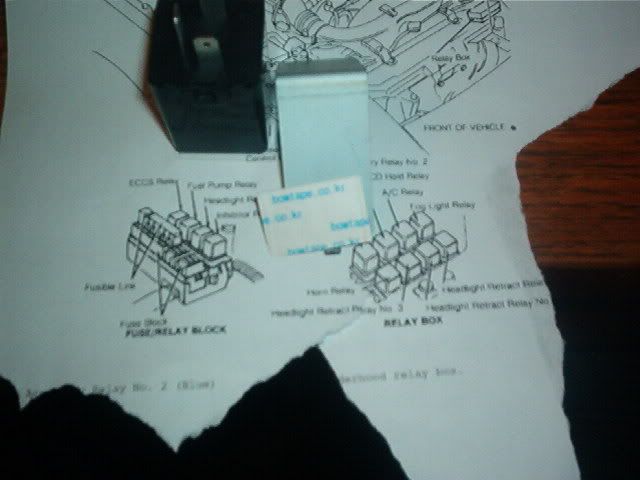

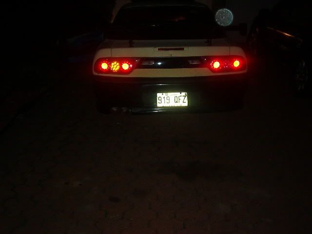

Hello i am hoping some here can clear this up for me.
I instaled some led tail lights and they came with a relay.
I didnt use the included relay and all was well for a hour or so but now strange things are happening.Now i am going to use it
I have searched and downloaded the shop manual; found the location i think
my question is ,, in the manual they say the relay is in the box near the air filter,, but when i look at the cover of the box is has differnt discriptions for the relays located there there than in the service manual. its a 89shoc
should i just go with the picture on the box,, or the manual, or What i was thinking just swap the relay and see what happens ??
Im open to any related help or ideas
idrive240
the led tails came with a 90degree piece of metal some doubble sidded tape and the relay.

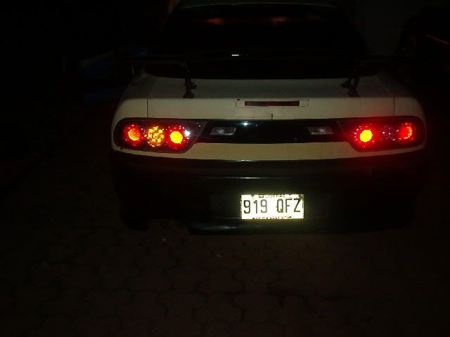

the strange things are; no left front blinker when head lights are on and the turn light in the rear stays orange same side

i know you have 3 posts.. and i'll try to be as nice as possible.. but god, those taillamps really make me want to throw-up. they're so gaudy.
the parking lamp circuit, brake lamp circuit, and signal circuits do not have a RELAY.
the signal circuit DOES have a 3 wire flasher, which is most likely what that black box is.. its a flash module.
the flasher module is located underneeth your steering column, you'll hear it click when you turn the signals on. be sure to have extra fuses when fucking with this crap, because you'll most likely need them.
good luck

hey ixfxi
that worked my friend put it in for me
