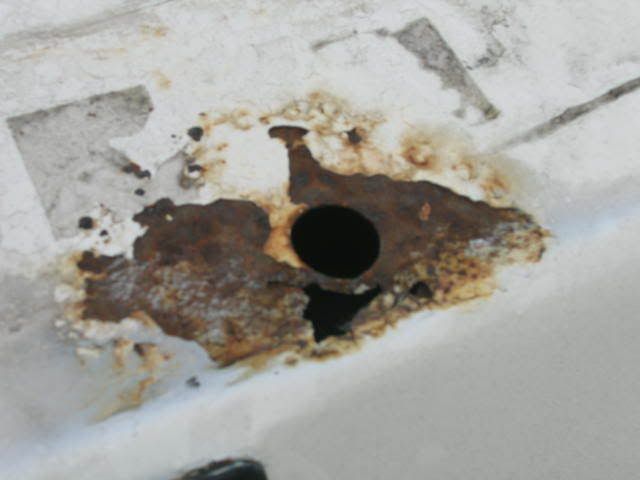

Once off there's almost a dozen holes to weld up. Good luck with it.

i pulled mine off only to have the wing disintergrate in my hand and discover that kinda yellow reddish gold black stuff that is kinda flakey. yup... rust! and lots of it.
beware of what lurks beneath!
had it cut out and welded up and refinished. better than new!
mine had a total of 10 holes.

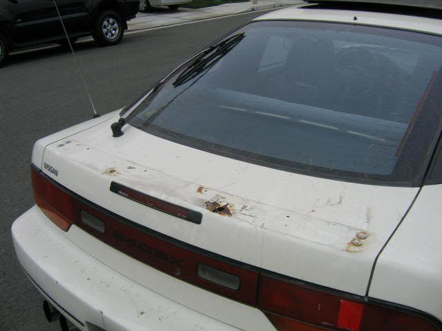

Here is where all the holes are. Where there is eletric tape there is a hole. Since my car is black i just used tape. I have had it like this for 3 or 4 months. Been rained on snow, car wash atleast 2 times a week and dosent leak.

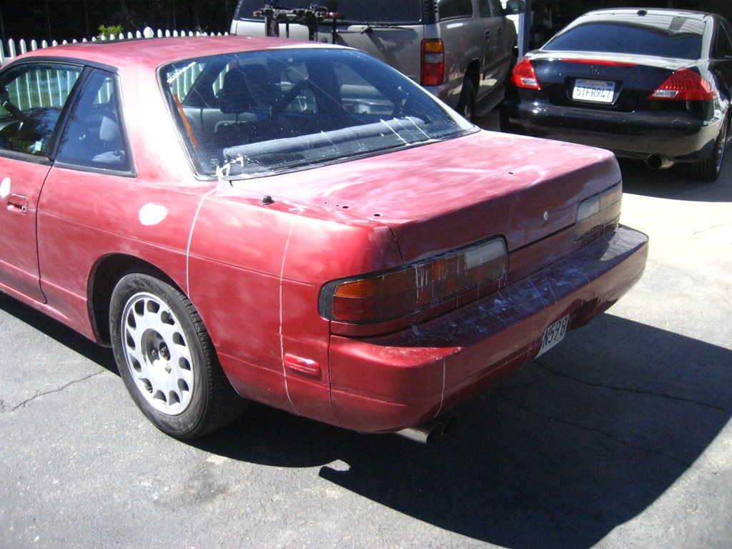

woo hoo. got it off!

Old 03-17-2008, 04:11 PM   #27
Skeeg
Location: ohio
Posts: 54
Skeeg is just really niceSkeeg is just really niceSkeeg is just really niceSkeeg is just really niceSkeeg is just really niceSkeeg is just really niceSkeeg is just really niceSkeeg is just really niceSkeeg is just really nice
holy poop trunk!

Old 03-17-2008, 04:22 PM   #28
imnotmatt1189
imnotmatt1189's Avatar
Location: Stockton, CA
Posts: 1,118
imnotmatt1189 is a splendid one to beholdimnotmatt1189 is a splendid one to beholdimnotmatt1189 is a splendid one to beholdimnotmatt1189 is a splendid one to beholdimnotmatt1189 is a splendid one to beholdimnotmatt1189 is a splendid one to beholdimnotmatt1189 is a splendid one to beholdimnotmatt1189 is a splendid one to beholdimnotmatt1189 is a splendid one to beholdimnotmatt1189 is a splendid one to beholdimnotmatt1189 is a splendid one to behold
ahahha that's not bird poop. it's just like that cuz i was wet sanding cuz i'm getting ready to paint the damn thing.
