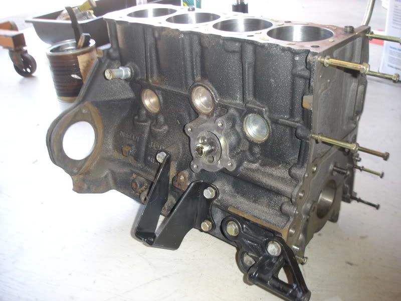

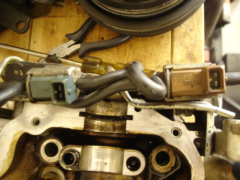

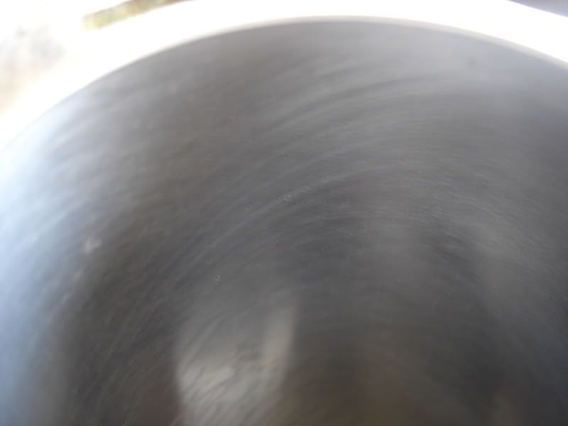

alright well, i got my block back from the machine shop and my parts came in, so its ready to go back together!
so does this mean i can use mobile 1 oil now enstead of some high milage oil? haha as long as it isn't synthetic right?

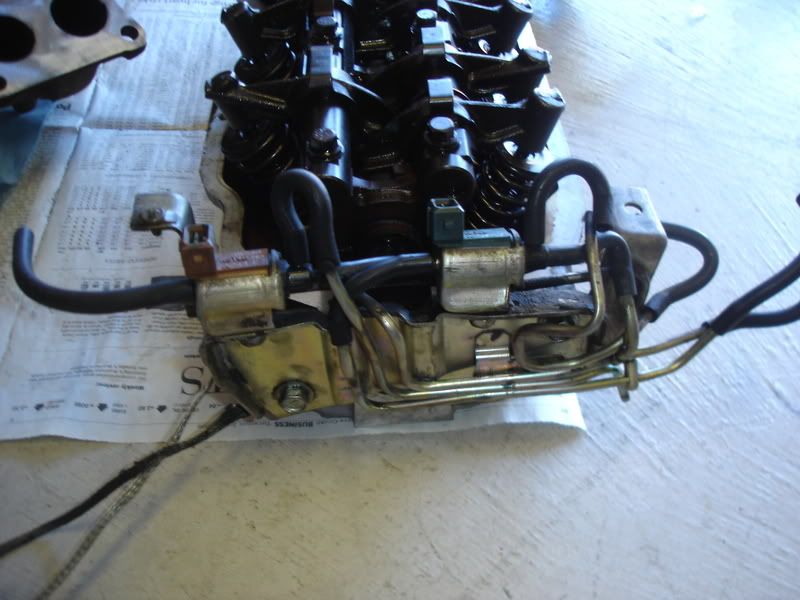

also about the vaccume hoses on the head, which of these can i remove ?? or can i just remove it all?

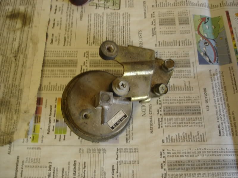

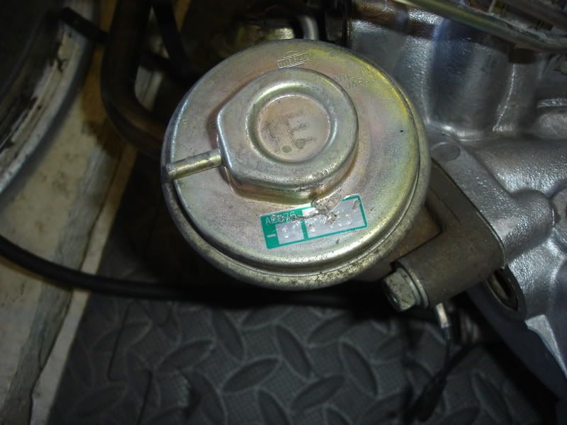

also do i need these

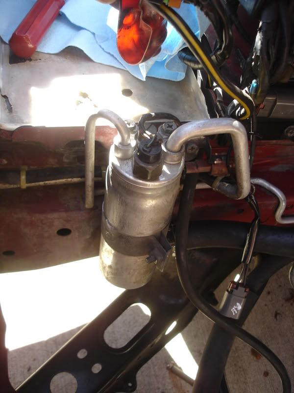

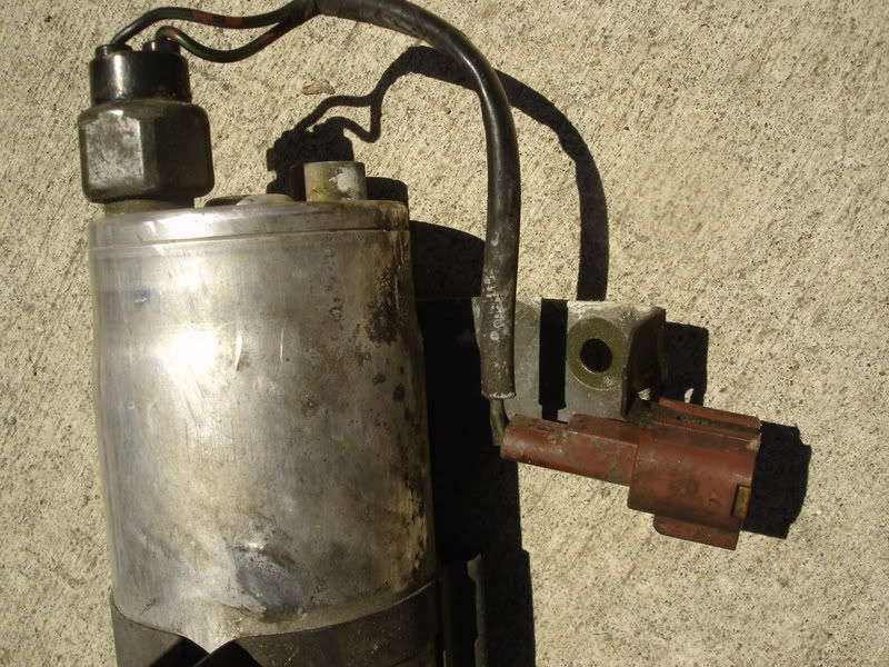

AND is this part of the AC? if so i can rip this out right?

The rest of that stuff you can take off, you just need an EGR blockoff plate. And you can remove all that shit, just make sure to cap off the lines that won't be used under the throttle body.
Yes, that is ac shit.

so i can remove all that vaccum lines behind the head?

to be totally honest, the only small vacuum line you have to run is one to the FPR. All the rest are emission related.
And the black canister is also connected to the fuel tank breather line, unhooking this and leaving it vented to the atmosphere supposedly looses alittle more gas to evaporation(the vapors would normally collect in the intake plumbing when it's all hooked up, and get burnt up at startup), but that may just be a rumor.

^ yes to the fuel pressure reg.... AND dont forget the brake booster lol i forgot about it on my s12 last time i re thought the vaccum mess. also for a good running car, you should run air hose from the intake before the throttle body, to the iacv or whatever its called with an idle screw on it. and u dfont need any of the bullshit you asked about unless ofcourse you live in california or something silly like that.
btw. the block is lookin good. what all are you throwing in there??
looks good!

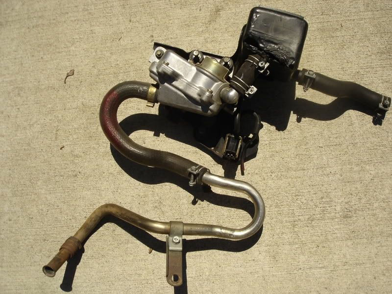

1st pic: those lines are for your egr and secondary throttles. if you are removing both of those systems, then yeah get rid of all that.
2nd and 3rd pic: those are egr actuators. again, if you are not going to use your egr system anymore, then get rid of em.
4th pic:that is your aicv or air injection control valve. it pulses clean air from your ntake into the exhaust to clean up the emissions of the vehicle. often these valves become dirty and stick open causng exhaust gases to leak into your intake and reduce performance. i would eliminate it.

whats this..?
carbon canister. get rid of it if you like.
yes that is part of the ac. its the ac evaporator in case you were curious.
haha thanks, well due to my lack of money im just throwing in the stock internals back in there with new piston rings, and new rod and main bearings..

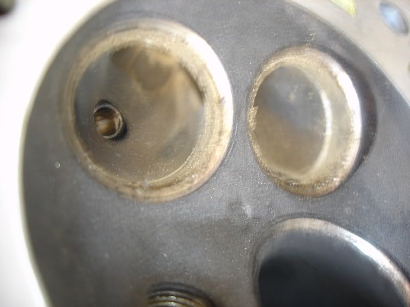

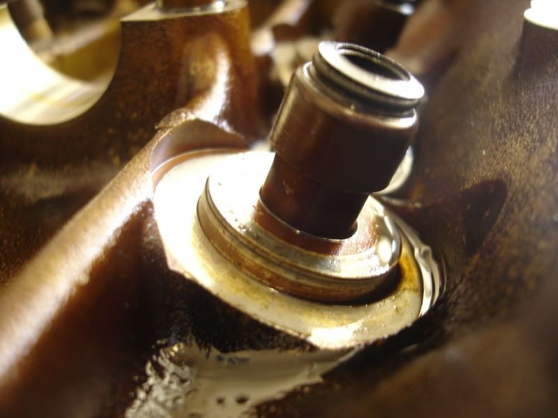

and also i got all the springs off my head so i can replace my valve seals,
how do i get the seals out? don't i need to somehow get that ring that fits around it off?
heres the seats

remove that whole mess of hardlines behind the head, just unbolt it. I just left those plugs unplugged when I did it and had no problems. There are vacuum caps for sealing off unused vacuum ports.
No it's not. The evaporator is found inside the car. That is the receiver/drier.

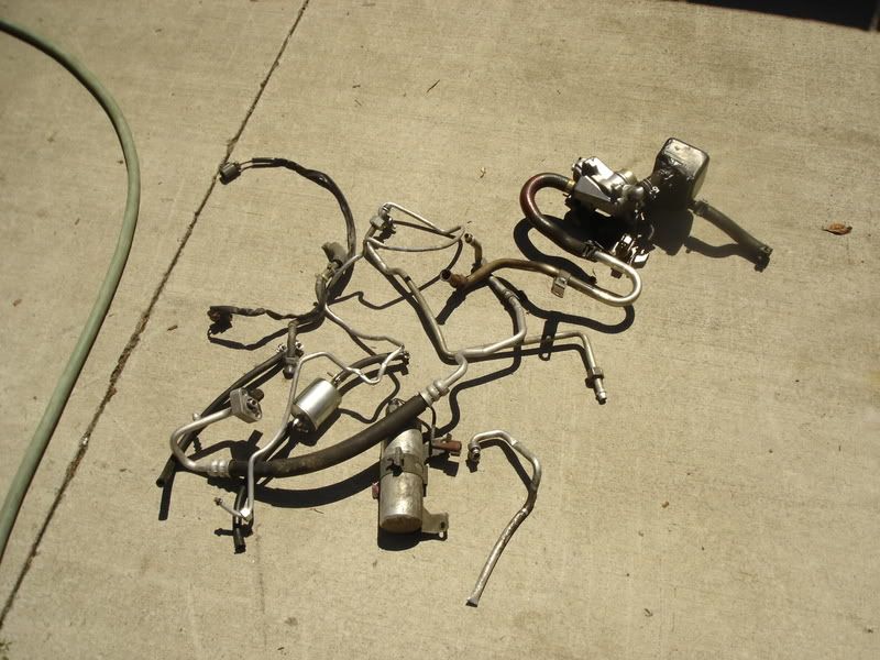

also i began ripping out some of the emission stuff in my engine bay / ac conponents and just seeing if i removed everything in the engine bay, pretty sure i did since the charcol canister thing is pretty much all ..
byebye!
this is part of the AC right? so i can remove it, and there is a plug that goes there, when i go to hook everything back up do i just leave the plug that normally goes there just chillin?

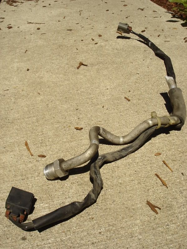

and this was ziptied onto one of the AC metal lines, and it plugs in near the front near the bumper, anyone know if i need this
and, i can just get rid of this whole thing right? or is there parts in here i need..?

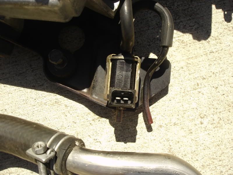

and same with this, there is a plug that hooks to this, do i just let it chill when i got to hook everything back up?
Options13 is offline   Reply With Quote
Pliers and some cojones.
heres the seats
Did you get those reground?

Old 07-12-2008, 10:00 AM   #16
ManoNegra
ManoNegra's Avatar
Location: Socal
Posts: 7,841
Trader Rating: (48)
Feedback Score: 48 reviews
The contact/sealing surface of the valves (the edges). If keeping the old ones, we usually have them reground at the machine shop at the same time we have the bore and deck cleaned.
/\/\ he is right. my bad. thanks for the correction.
