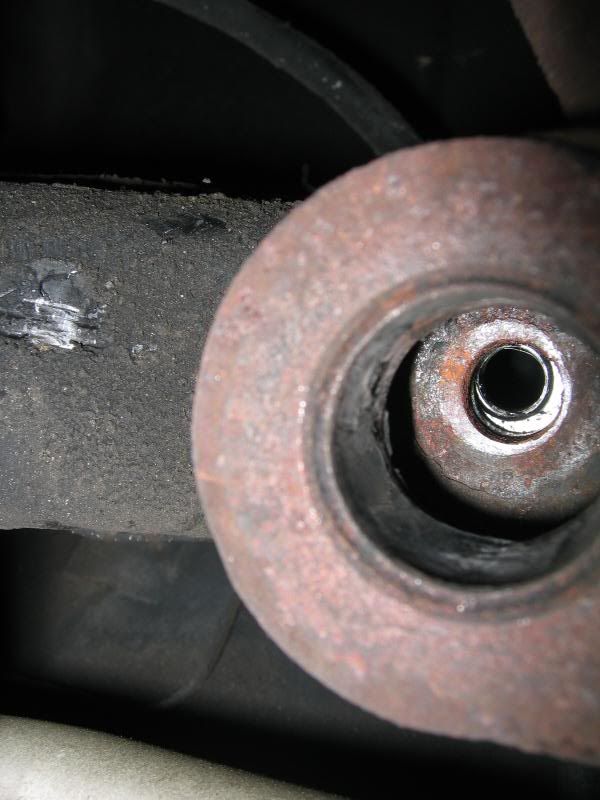

yeah the back four are off. gave a bit more clearance but not enough. here ill post a pic of the bushings
reccakun08 is offline   Reply With Quote
Old 07-15-2008, 11:48 PM   #4
reccakun08
reccakun08's Avatar
Join Date: Jun 2003
Location: Rockville, Maryland
Posts: 1,090
reccakun08 is a jewel in the roughreccakun08 is a jewel in the roughreccakun08 is a jewel in the roughreccakun08 is a jewel in the roughreccakun08 is a jewel in the roughreccakun08 is a jewel in the roughreccakun08 is a jewel in the rough
Heres a pic of the metal lip i am talking about not allowing me to slip on the bushing.

it should go in with out a problem
what hard were are you using i used some off a j30 idk if theres a difference between the hardware on that and the z32
take a pic of the hardware?

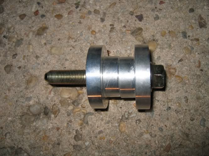

First pic is the hardware the top and bottom bushing and the new longer bolt

From this pic it seems as though i can punch it out. but i am not sure.
The bushing fits nicely without the lip.

those don't look like the j30 ones
the bushings look BIG
are they the ones that came with the diff
go get some stock hardware and should go in easy

according to splparts http://splparts.com/main4/parts/S13/...me/default.htm they fit many vlsd. i have z32 n/a VLSD.
they are aftermarket solid bushings

The lip you see is the stock outer bushing shell/sleeve. Usually you remove it as one piece with the bushing, but I guess the bushing was old enough that it came apart. You will need to remove the sleeve, and to do that you have to take off the diff...
kuah@splparts.com is offline   Reply With Quote

Its not our fault that Nissan pressed the bushing in from the top You might be able to cut it out with the diff on the car, but that may take longer than removing the diff. The sleeve can be knocked out with a hammer and an appropriate driver (eg. socket of right diameter).
