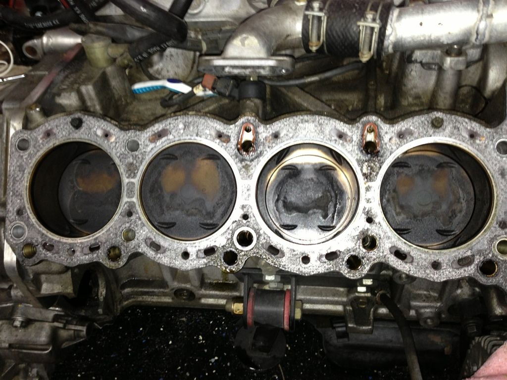

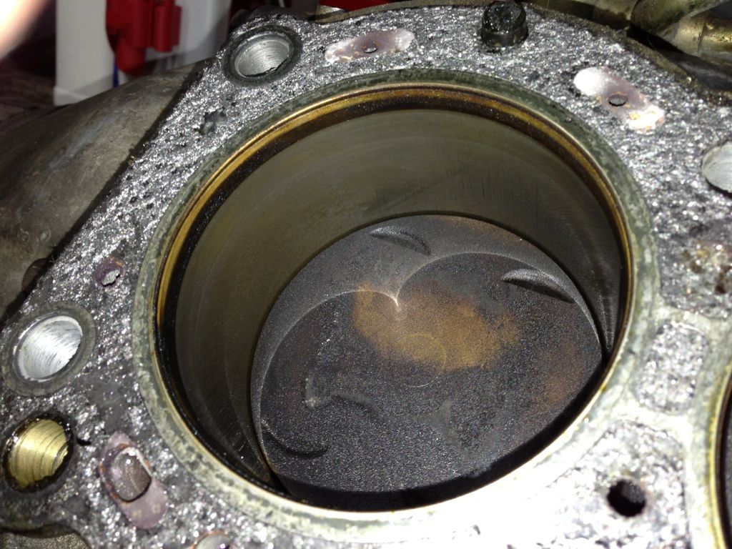

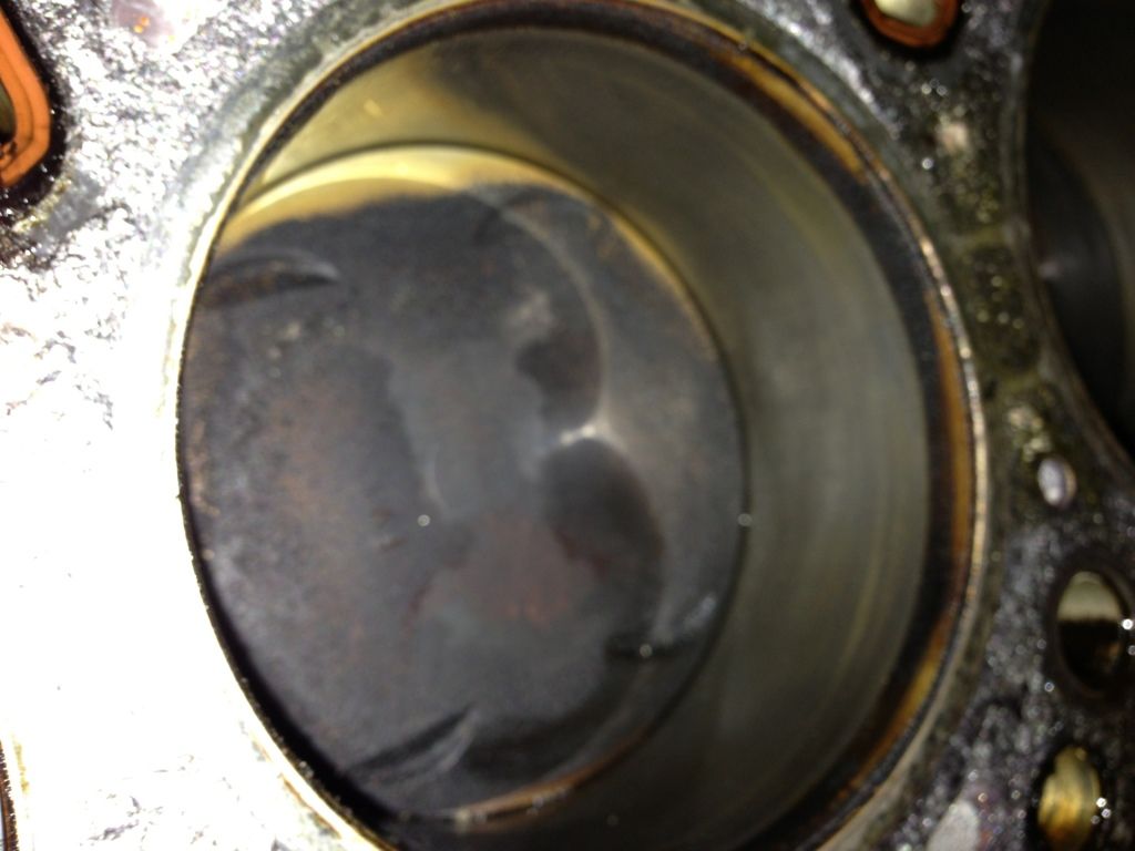

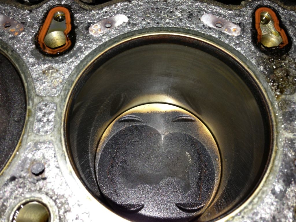

so i got one cylinder head off.
As i removed the bolts in sequence and stages of course i came to one that was just not as tight as the rest. And i though hmm thats not right. I mean it wasn't loose by any means using a breaker bar they all required a pretty good tug, except for the one above cylinder 4 on the top it was just a little looser.
Anyway pulled the head and this is what i found.
Piston number 4 seems a little cleaner than the rest, towards the top near that bolt, and I'm wondering if this may have been the culprit. Compression on that cylinder was good of course.
Heres a closer pic.
Cylinder walls look great for 126,000 miles.

Why's your V8 have so many valve reliefs?
Lol so weird seeing OHV V8's. Anyway, walls look great, pistons look great. Slap it back together with the new heads man, enjoy it some more, use that bottom end money to buy something cooler (or save it for when something big does happen). You're not boosting enough to need to re-ring, you don't really need forged slugs in it, that little S-trim is perfect for that engine.

Jordan i wonder the same thing my self. I might just do the bearings and some rod bolts, I'm just worried about spinning a rod bearing a month after i put it back lol.
I think it maybe an anomaly for the clean cylinder i just pulled the other head and they are all like that on the other side.

It's clean because water will steam the cylinder releasing any carbon build up. Get the injectors cleaned. It was together to long to just pop. Something happened

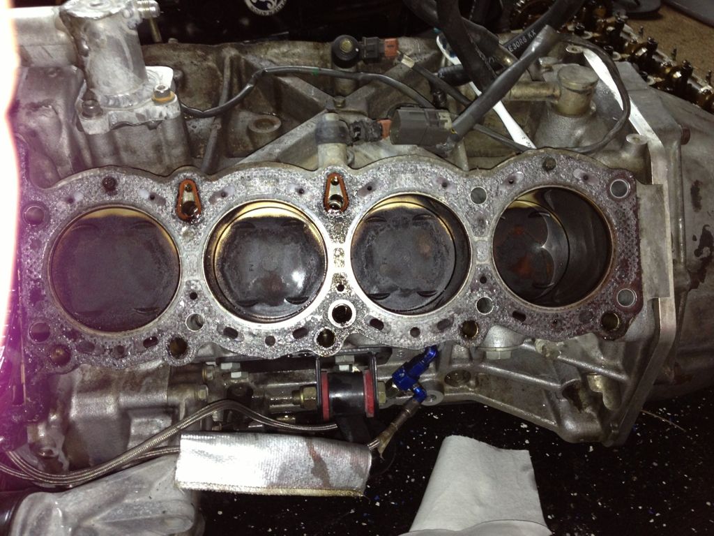

So decided to go through with the bottom end pulled the tranny and put it on the stand.
Twin plate love...
pulled the timing cover and the motor looks brand new inside.... Not bad for 126,000 miles. Starting to think I'm wasting my time but whatever its half disassembled. I bet the bearings look new as well. Le sigh...

so pulled the pan...
Heres a nice shot of my smashed into oil pan pick up...... I must stress this has been like this for two years and never lost not even 1 psi of oil pressure thank god.
Nice and clean bottom end...
So pulled one rod bearing from each of the throws. And as suspected this was a big waste of time. All the bearings are clean and have minimal wear. I should have just slapped the heads back on and been done with it. But whatever what can i do.
