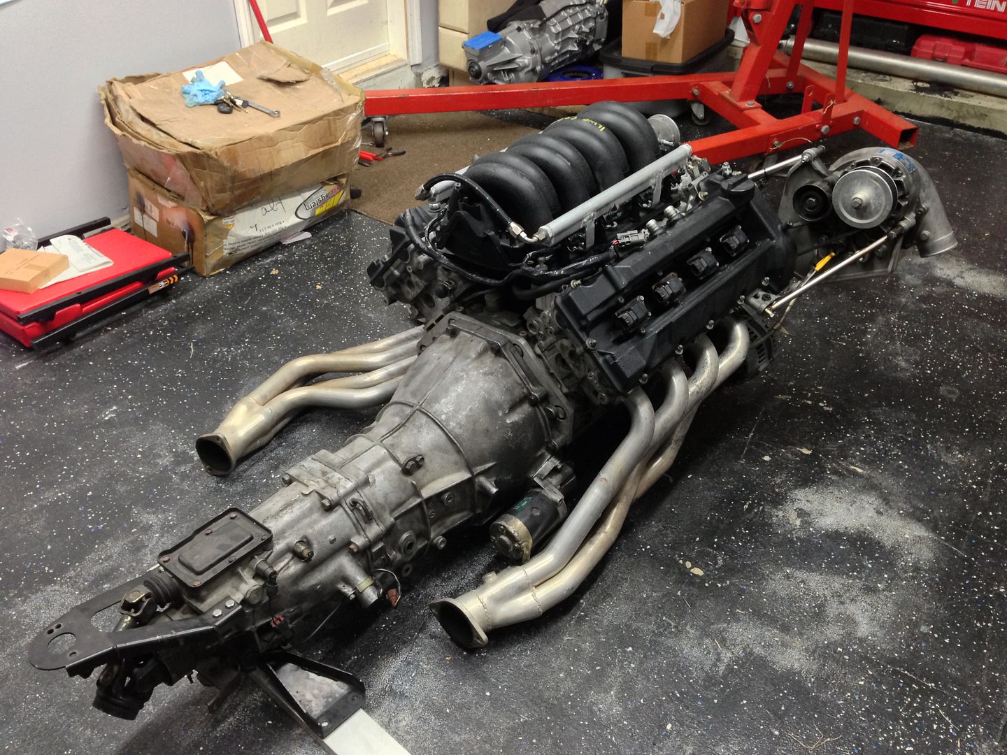

I took a few pics of this car in 2011. I didn't realize there was a build thread.

thanks for the pics!!!

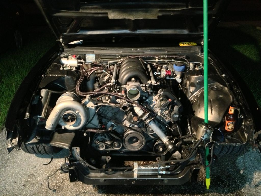

Well i ended up blowing a head gasket or both, don't know but at least one is definitely done. Started pulling the motor tonight. Next thursday will be 4 years to the day that this car has ran with no problems. So i can't ask for more than that.
I figured i would take it out and remove the heads, replace the head gaskets, put some arp head studs and install the built heads with cams I've had sitting on the shelf for a few years.
However I'm starting to have my doubts about this, i think I'm just getting to old for this crap and I'm contemplating sell the whole vh45 setup and buying an lsx crate motor and drop it in with that sick t56 i have sitting in my garage.
I really don't know what to do at this point other than keep removing the engine.

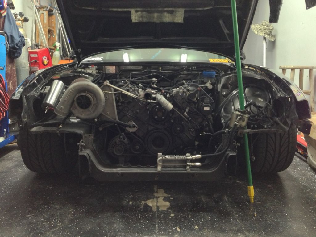

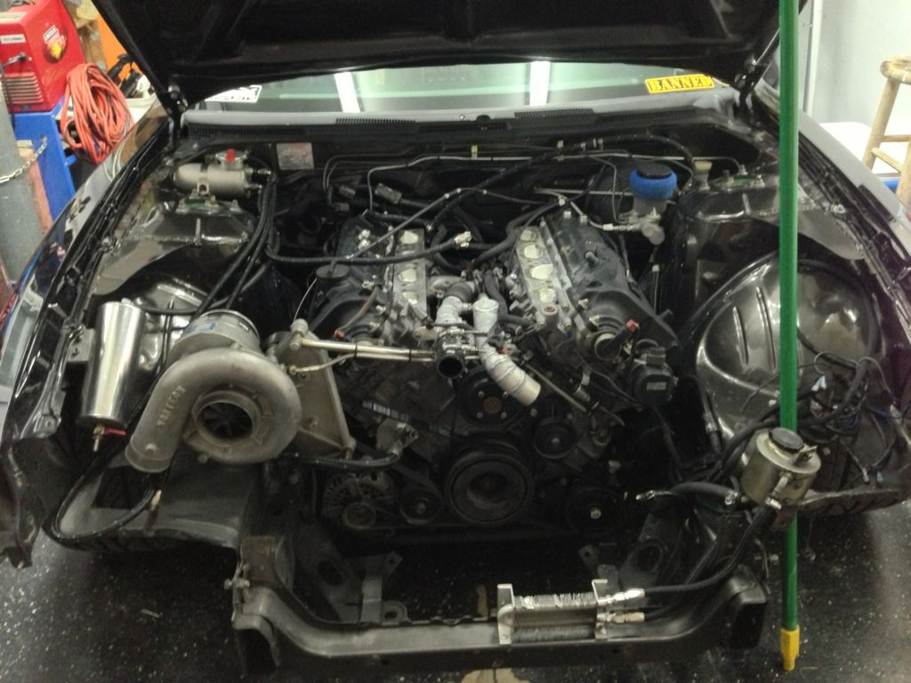

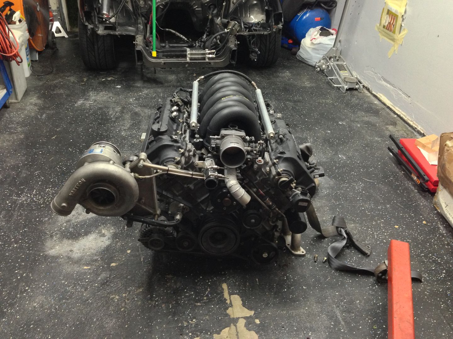

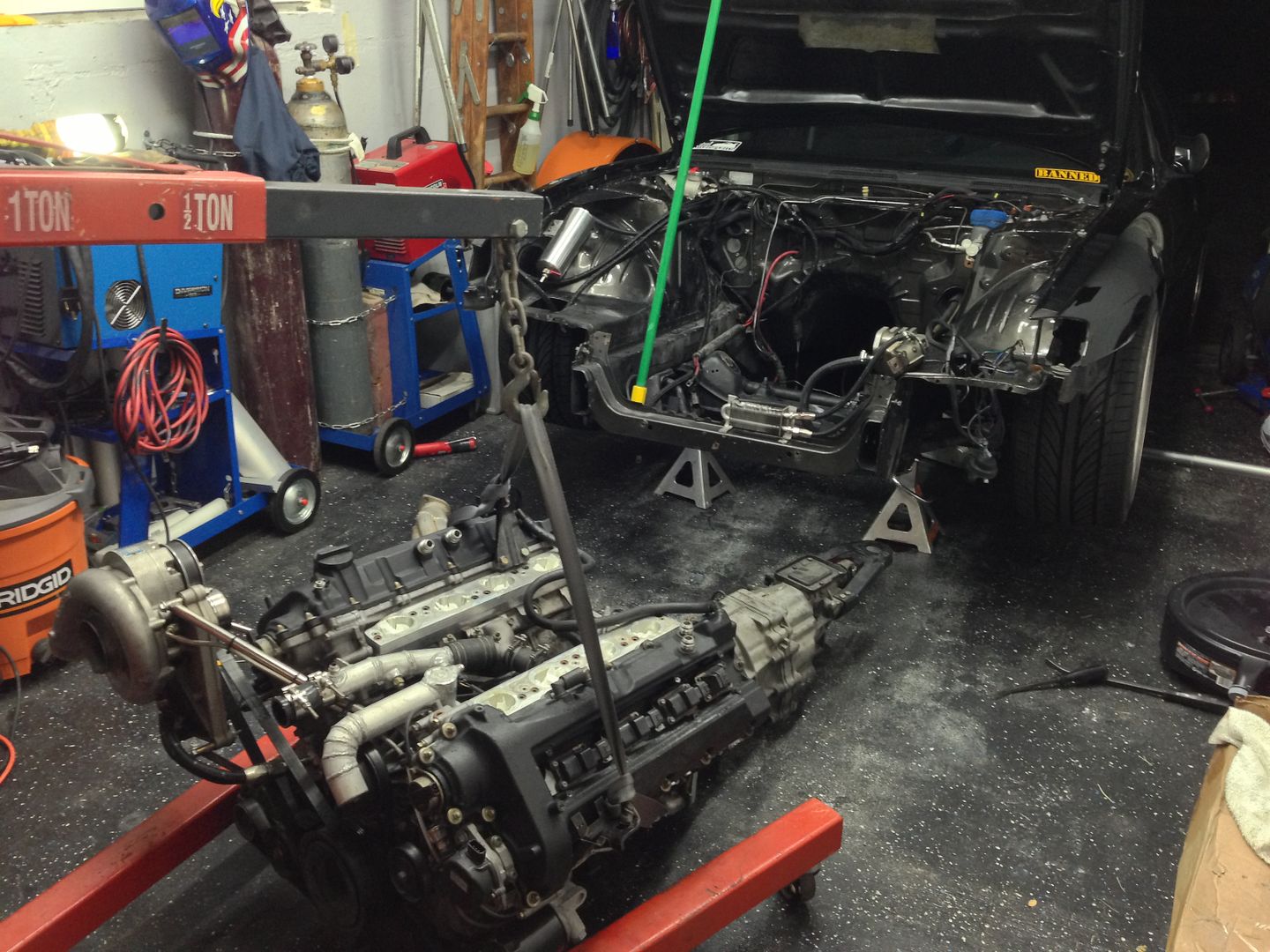

Well finally got the motor out tonight. Didn't do anything yesterday and went to the football game today, got around to it around 6pm took about 3.5 hrs to pull the rest.
Tear down begins tomorrow.
Ive never had the motor out of the car with the supercharger and intake all bolted up being as that all of those mods where done with the motor in the car so heres some pics from different angles.
Its a big Bitch for sure.

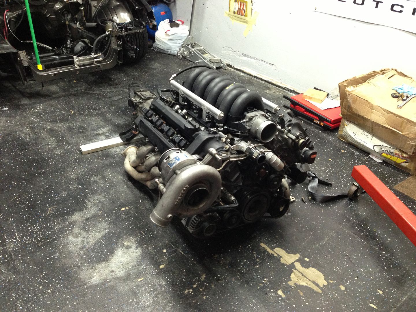

so put the motor off to the side and started the tear down. Decided to do a compression check before i pulled it apart out of curiosity.

Popped off the valve covers and this motor is still as clean as the day i bought it. It has roughly 126,000 miles as of now.
Cleaned up the valve covers and dropped them off at the coaters I'm done with wrinkle black, I'm thinking silver or something crazy.
