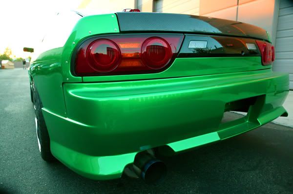

here's how mine are, but this is a full time track car, so I'm not worried about crap getting up and into the interior. I have made a few aluminum panels to block the tire smoke but it still builds up in there like crazy. Yeah it was great for weight reduction though. I used chargespeed 50mm blister overfenders and couldn't say enough for them, the fitment is spot on. Yeah thought this might help...
