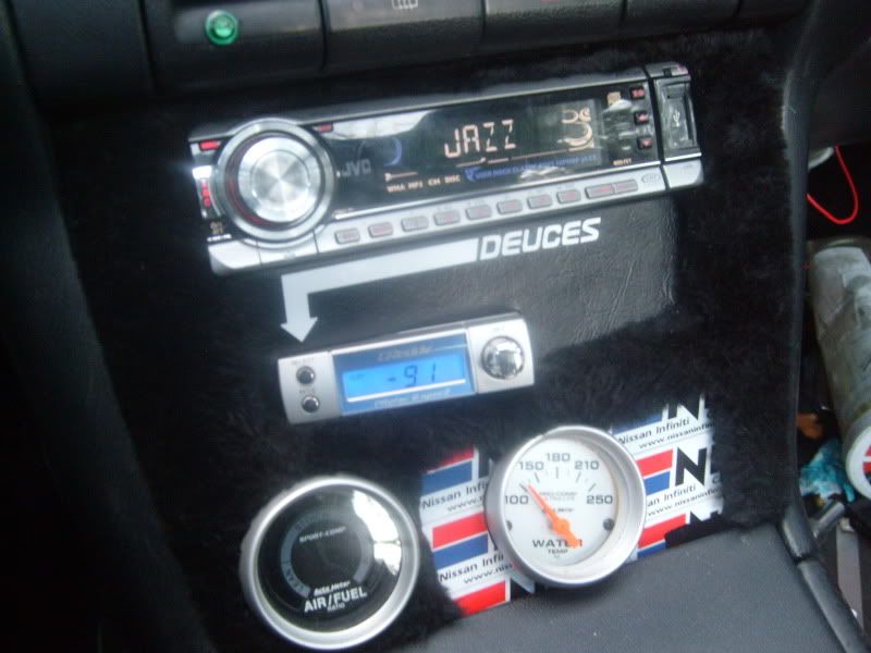

Please tell me this couldnt be the Boost controller valve. I have a Profec B-Spec 2. I switched it to Hi, boost said bye. Stupid bitch. Im gona go look at it now. Its snowing so its allways fun.
