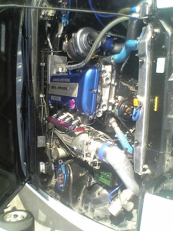

You can rock an S14 Block with Red top Head
This guy did it.
Short Blocks are exactly the same with a few small difference, Oil pumps, Oil pick up...
This guy did it.
so would you need to change the oil pumps and pick up for it work? I have a zenki s14 blacktop, but I came across a fully built redtop head that I was interested in picking up, how would I make it work?
