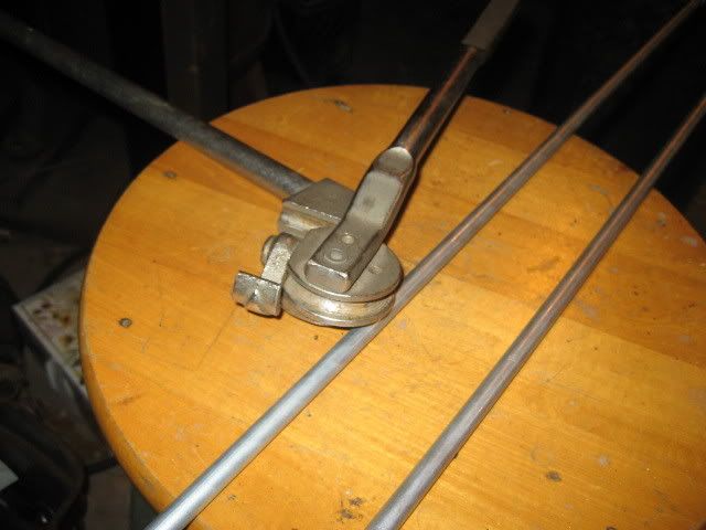

So heres what i did with my coolant lines today. I went to napa, ANY local parts store and got whats called 3/8ths inch 'brake line'. Now, at that size no one uses it for brake lines, but its made out of a bendable steel that works well with coolant. Just so happened to have the 3/8ths inch tube bender handy, and figured id go for it. Also bought these steel compression tube fittings from McMaster.. Part number ---> 5929K23
Heres a pic of the line, and the tool i used. Im not sure how much the tool is, this is an old school one but it works great. If any of the ka-t guys want to borrow it we can work something out.
So i just kinda went at it, hacked the 5 foot sections into a more usable piece of about 2 foot sections. I first started off by using a few scrap pieces to figure out how the thing worked, and how to make the bends exactly at the point you want them. I went through 4 sections of 3/8ths inch tube through this. They are cheap, under 5 bucks a section.

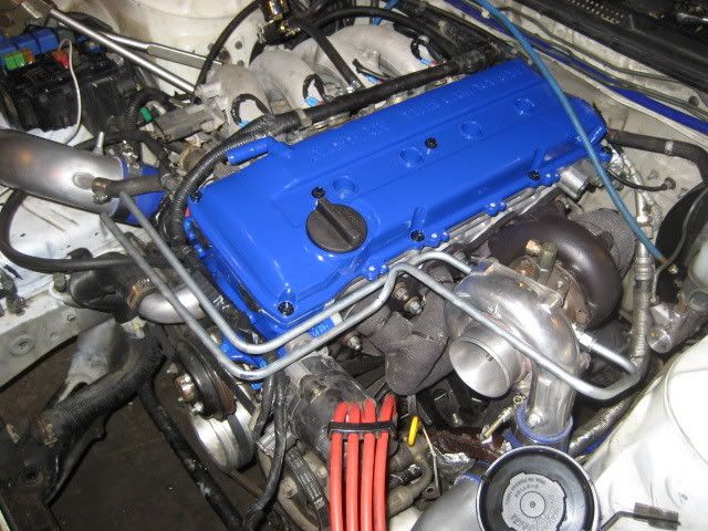

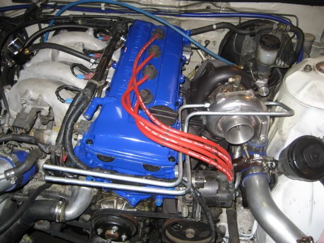

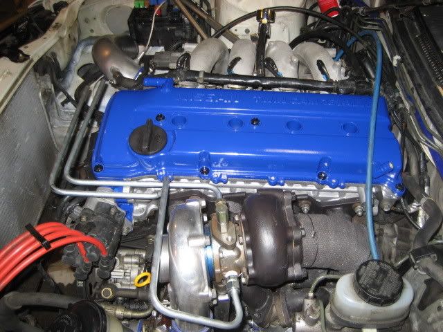

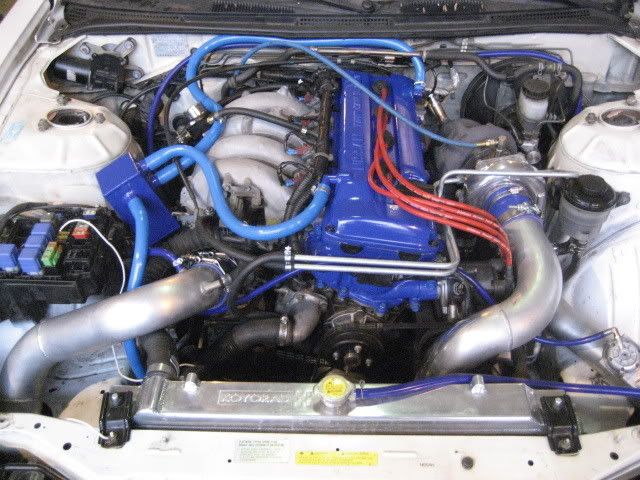

I was left with these..
I think the aluminized coating on them looks pretty good, so i was gona leave it like that. When i took off my intake manifold, i went ahead and got a big piece of rubber coolant line and looped it in between my water feed, and return line. I made sure there was enough line left so when i was doing these hard lines, i would have enough soft line to connect up with the lines running to the turbo. Heres a pic of that..
So tomorrow ill go ahead and finalize everything and make sure the compression fittings worked right.
This was the end result.
Heh ignore the red wires..
