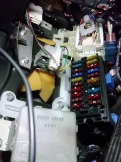

I got my car running again(intermittent short was caused by corrosion on alternator fuse) but I noticed I don't have dash lights now. I know they were working last time I drove it and that was coming home from having a stereo installed. Well I popped my fuse panel and checked the fuses that I thought would be the problem and this is what I found:
Is this the right fuse for my problem and if so how would I go about fixing this?
Edit
Stupid photo bucket resized my pic. The text says missing fuse connector.
I just remembered something that might be useful, the previous stereo had a wire coming over to that fuse, I wont to say it was the illumination wire but I'm not sure.

there is a white box by the fuse box. Find a new one and replace it. It always gets blown out when you put in a new sterio for some reason. But if you have an HUD cluster the HUD has to work for the dash lights to work

yup what he said in the driver side kick panel there is a white box. i used to have the same problem until i replaced that.

It's a fastback, no HUD.
What about the missing connector?

There should be nothing from the stereo plugged into your fusebox. If all fuses are good and they're all in place (the missing one may not be used, your fuse cover will list the fuses and circuits), then replace the TCU.

Well I grounded the illumination wire in the stereo harness. I have dash lights again but I still have something drawing power from the battery when the car is off.
