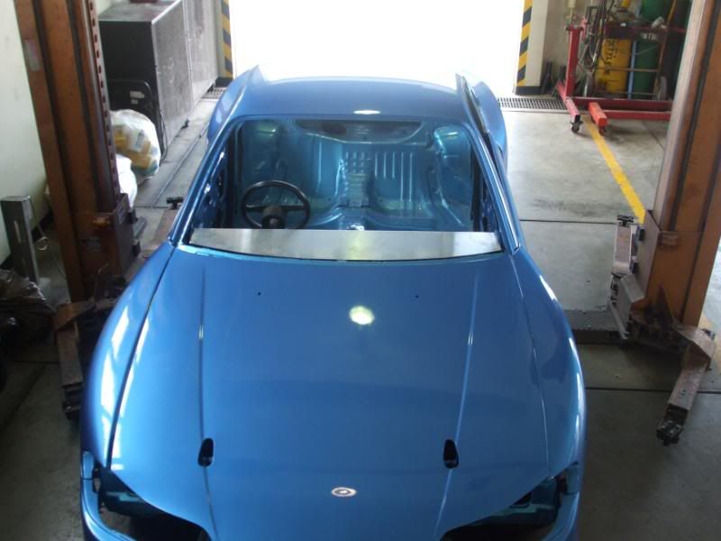

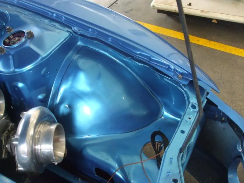

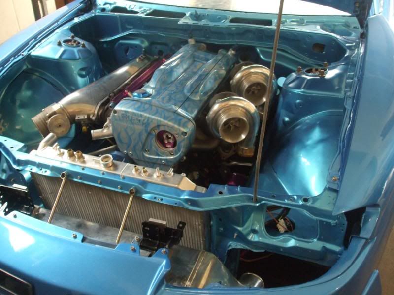

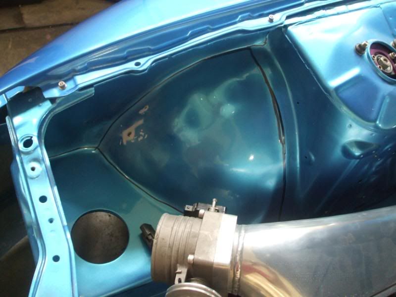

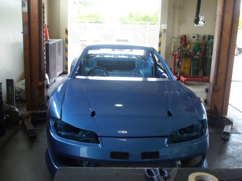

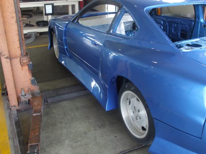

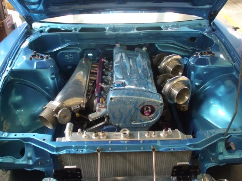

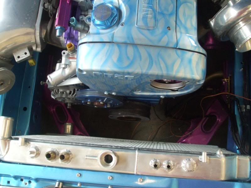

Here are some pictures of the motor in the bay and some other pictures here and there. You will notice the black sharpie marks all over the front of the engine bay. those are my cut lines for tomorrow when I start cutting all of that crap out to redo it in sheet metal. Have a good one and enjoy.
