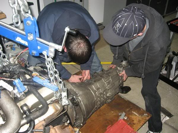

Got the motor in Friday and started tear down:
Day 1:
At the end of Friday evening:
Few more I forgot:
Yay, wiring (not to mention cut wiring from Osaka, f***ers can expect a nice call tomorrow) :rolleyes
Ahh yes, just an FYI, the car getting the swap...5Zigens aren't on this pic, sportin the winter s*** now
Day 2:
Painted the block flat black with high temp enamel. Silver head, once again, high temp. Exhaust manifold and turbo hot side, flat black, high temp. Valve covers are an extremely dark blue. Front timing cover is also gloss black.
Still more work to be done, but its getting there.
Marc's work on polishing the turbo...
I like this pic...
Mocked up...
And at the end of the day...I had some extra paint. Flame as you must, but I think its *%&**%&**%&**%&*in bad a**. Nobody will ever see it, but Ill know its there :xxrofl:

Nice hope the harness thing works out for you. Also, yeah you should change all of the gaskets, seals, hoses, belts, water pump, etc. you can while the motor is out. You won't have room once it's in the car. What motor/trans mounts are you going to use?

95% of the gaskets are getting changed minues the ehad gasket and the timing belt. Its my decision, I have my reasons, you dont like it, STFU.
Going with McKinney tranny/motor mounts and drive shaft.
