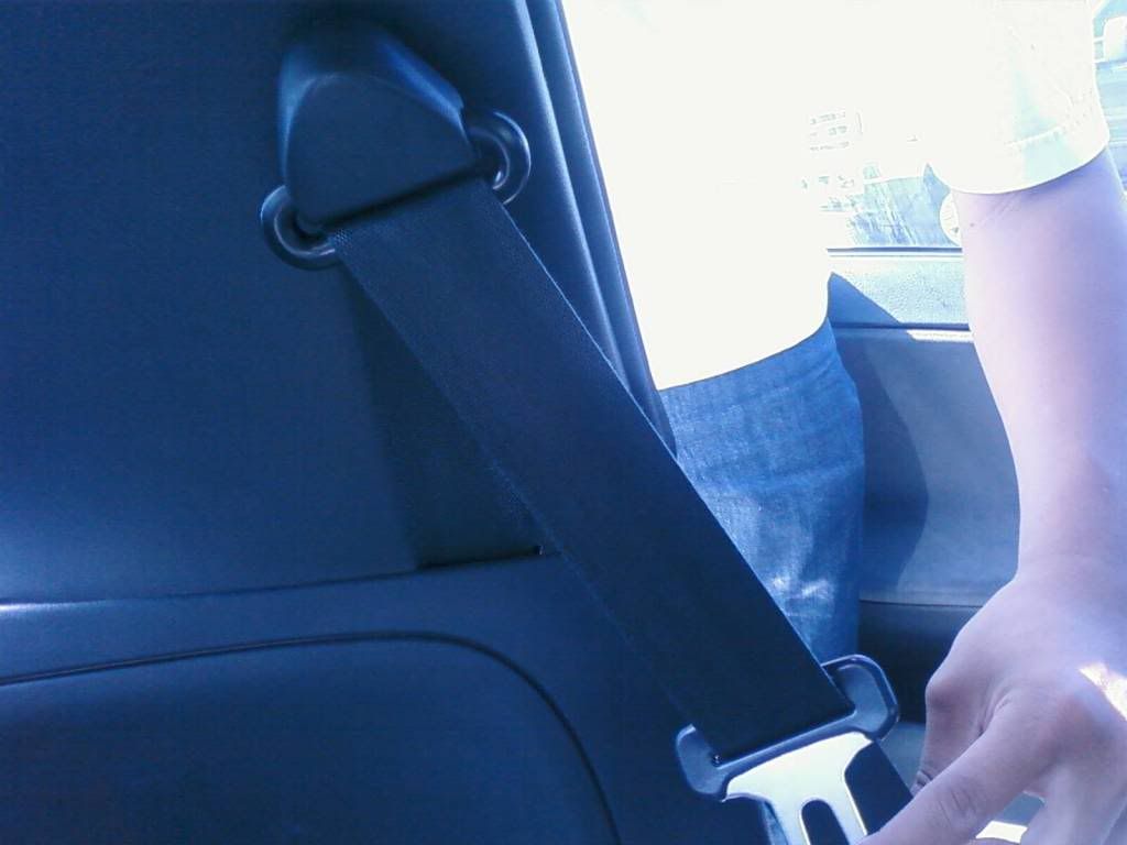

shade
shade's Avatar
Posts: 509
shade has a reputation beyond reputeshade has a reputation beyond reputeshade has a reputation beyond reputeshade has a reputation beyond reputeshade has a reputation beyond reputeshade has a reputation beyond reputeshade has a reputation beyond reputeshade has a reputation beyond reputeshade has a reputation beyond reputeshade has a reputation beyond reputeshade has a reputation beyond repute
My set up. Sorry for the camera phone pic. Don't have my camera right now.
shade is offline   Reply With Quote
Old 04-15-2009, 12:33 PM   #34
Brian
Brian's Avatar
Location: usa
Posts: 12,840
Trader Rating: (54)
Feedback Score: 54 reviews
so, did you also dremel out that little "slot" for the belt to pass through?
http://bhworld.wordpress.com/
Old 04-15-2009, 12:34 PM   #35
shade
shade's Avatar
Posts: 509
Yup. Just make it real smooth so the belt can slide back in.

Old 04-15-2009, 06:04 PM   #42
ms!3
Location: USA
Posts: 1,563
Wouldn't spacers and extended studs be weaker? Wouldn't want my belt to rip off the car in a wreck. Maybe I'm off, just a thought.
I know for a fact eclipse, s12, and protege belts work. Don't have to limit yourself to just s14 belts.
ms!3 is offline   Reply With Quote

i did what the second guy did, back when i had those seatbelts + interior. i ditched all that shit, rollbar and schroth rallye cross harnesses.
when i ran s14 belts, i made a hole, longer bolt, spacer, and cover. worked like a charm.

I want more info on this. What did you use to line that hole? Looks like some kind of plastic insert? I've been holding off putting mine back on because I didn't want to cut a hole and miss, then have to replace them.
EDIT - Also, from what I read around on the internet when I did this swap in my coupe (god the auto belts suck. I remember mine catching passengers and getting them stuck lol), almost all Honda belts will work in the s13. Go find an old mid 90s civic, there was a billion of around.
