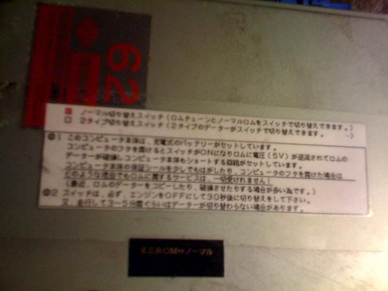

Speak japanese? PLease translate
i need someone to tell me what my ecu says on it, i know it has two maps and i beliee it says what they are on the front but i dont speak japanese, and i really need to know what this ecu is tuned for.
if you need a better picture let me know.

ill try to get a better picture later, the car is setup exactly how i was told this ecu is tuned for, but its dumping a rediculous amount of fuel to the point that it make my eyes burn and the car is damn nere flouding out

kanji is too blurry for me to make it out, but the kana is ok...maybe soapgun can take a stab at in the blurry phase, otherwise we need better picss

gonna brave the thunderstorm outside to go get a better picture, im talking lightning thunder flash floods, should be fun

Yeah, the kanji just looks like blobs haha.

ok so i braved the storm and actually removed the sticker from the ecu and scanned it so hopefully it is good quality, any and all help is extremelly extremelly appreciated
here it is:
you should be able to blow it up pretty huge without distorting it

■normal change switch (change between no tune and normal rom tune ) □2type change switch ( 2 types of data can be changed) (1) this ECU comes with a chargeable battery. when you open the lid, it will be turned on and slight electricity (5v) will destroy data of rom and break ECU (static i guess). please do not peel off the sticker or take off the lid, we do not replace it. (LMAO) (2) make sure to flip the switch 30 sec after you turn off the engine. data might not change until 3-5 min of driving thats what i can gather...soapgun prolly can do better

[quote=shinmei- data might not change until 3-5 min of driving thats what i can gather...soapgun prolly can do better[/quote]
do you think that means that the ecu is supposed to learn the setup and store on its own? or am i screwed and somehow im supposed to access it and tune it myself without any idea what exactly it is or how the fuck to access it

i think if you are switching between the two diff maps it make take 3-5 minutes for it to kick in is what they are saying.

see heres the thing, regardless of what tune the switch is on the car is dumping fuel,

Heres a rough translation
Top Red dot says "ROM Tune and Normal ROM" can change switch
White Dot Says This button is two position switch
(Caution) 1 When ECU is conncted
If you open this computer cover, switch turns on 5V goes through ROM and will go back through ROM and Damage it
This ECU case will maybe short circuit if open while connected.
if this computer gaurrenty seal is torn or opened for any reason we will not repair under gaurentee
(So basically dont Open when connceted to Wire harness)
(Caution) 2 always turn off engine and wait 30 seconds and then change switch. sometimes (Rarely) after 3-5 mins of running engine data will not change.
Below sticker says "KSROM Normal"
They dont give a speciffic on what type of ROM tune though

this translation makes me happier, though i really need to figure out what its tuned for, cuz i am dumping a serious amount of fuel
