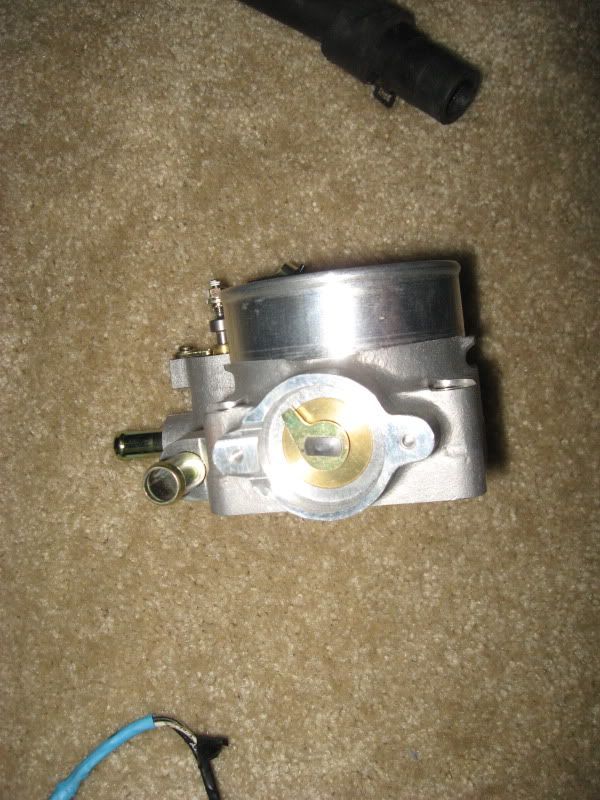

I dont know the order of the pic but problems are here as followed. BTW SR20det
1. the fuel injector rail, the brackets hit the IM.
2. The FPR hits the IM, How do i pull it out of the Fuel Rail any specialy techniques.
3. My SR20det TPS does not fit inside of the Tomie TB, what TPS will work with this?
4. On the Stock IM theres a metal line coming out, on the Freddy theres no nipples for this to connect to
5. to the right of the IAC theres 3 holes, im going to cap these off because i dont need them but when i do what gasket material to use?
Thanks any help would be extremely appreciated!!

1. I didn't have that problem.
2. You'll need the greddy fpr swivel or a remote mount fpr, I used an aeromotive.
3. You need an sr or ka late model tps, I think I used a '98, someone maybe able to tell you specific part no.
4. There's not a nipple but on the Greddy manifold there are threaded ports and screw in nipples provided, however this is for the collant circulation, I didn't hook mines up.
5. On the actual greddy manifold those are bpst threads and came with plugs, and I used teflon tape.
Thanks for the help! I have a SR TPS tho, ill try a ka tps. If you didn't hook up your coolant circulation can you take a pic of how you did it. What is BPST?

All I did was plug the two hole on the manifold that lead to the throttle body, and a later model TPS should work, I know the s14 sr20 tps works since its what I used, along with a KA not sure exactly which KA it is though.

Call West Covina ask for ray and tell him you want a s14 sr20det TPS, should be around $50 bucks.
British Pipe Standard Thread.
This looks totally like our american NPT pipe thread except it isn't. Screwing our American thread into it will totally ruin it. You'll need to goto probably a hydraulic store to get fittings.
