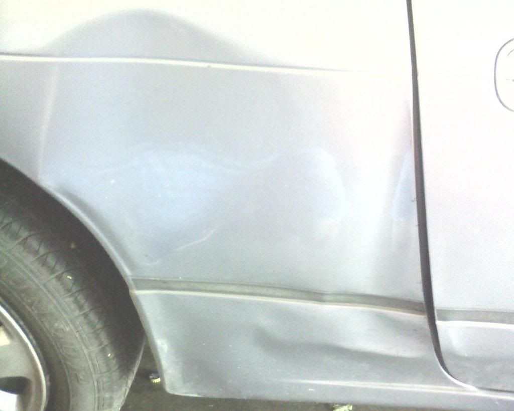

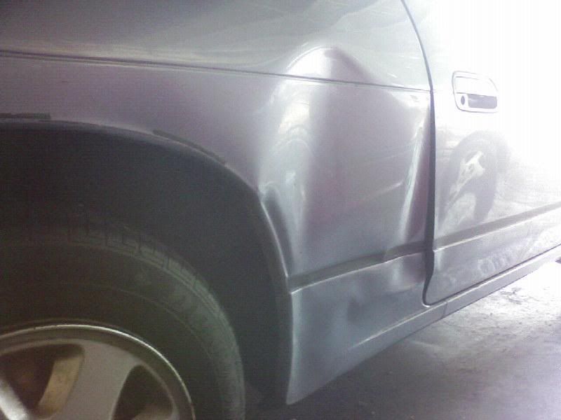

The door is ajar. The car is very straight with only 79,000 original miles and one big dent
I'll try to get behind it to see what I can do. I thought that you couldn't get to the dent because the inner fender metal was in the way. Basically I thought it was fender metal and then another piece of sheet metal after that.
I'm assuming most people on this board are anti-overfenders? I'm talking the $400 set from Chargespeed that covers the entire rear quarter and most of the rivets are with the body line or hidden

you can definitely get behind that dent if you remove your hatch area interior pieces. I think the basketball idea would be brilliant. Stuff a fully deflated ball in there and then start pumping.

i agree. just pop the son of a bitch out if you can. and if you cant take it to a shop. itl be worth the money. overfenders look retarded to me anyway.

Look yes he can push it out, true. but when he dose it will prob not comeout all the way and pop right back in, now if he pushes it out far enough to have it stay then he has pushed it too far and will have messed up the body line. now if he dose not care about if it is right or not then fine but i was just tring to help the guy do it the right way not half assed.
been doing body work all my life so to 93nismo step off, if u want to give people sub par advice then thats u, i am just trying to let people know the right way to do things. so please know what your talking about before u speak. thanks. And to op good luck i hope u find what your looking for.

I had a paintless dent guy look at it and use a suction cup to try and pull it out. He can't get behind it with a tool to pop it out. Doing over fenders I'll have to trim the fender wheels higher and when I do this I'll have access behind the panel to pop the dent out and then weld the lip back together. Just straight enough to get the over fender to fit smooth.
Remove your rear interior (both rear seat area & trunk area) & get the opinion of another paintless dent removal guy. Most of that area is reachable. There's actually inflation tools that Eastwood sells (I used one before for a smaller dent from pulling the fenders), but they are typically for smaller dents - you can still try, though.
