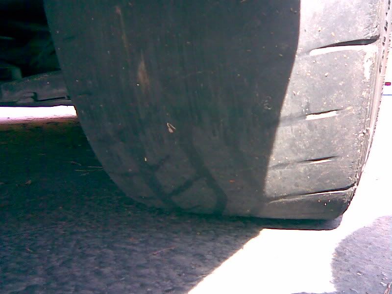

LSD kill my brand new tires??
My brand new Falken Azenis RT-615 235-40-17 only lasted ~4 months!
good alignment: zero toe front, minor toe-in back, -2.4 camber front -1.9 rear
~35psi all around
no abuse on the tires, used mostly for DD.
no autox or track, only mountain once for 30mins
Stock S14 SR on 10psi w/ aggressive clutch (on/off)
Stance GR+ Pro coilover (one finger gap between fender well lowered)
Tanabe Sways
SPL tension, tie rod, RUCA arms
Nismo 2 way (fresh Motul fluid)
Enkei TC105N 17x9 +12 (minor stretch tire)
while the front ones are still in good shape, the rears are completely gone. It got worn out evenly too (in the center while outside threads still noticeable)
picture taken when the rear cambers at -2.4

Can you get a pic of the tread to show the wear across the face?

here is a pic of the passenger side rear tire. The driver side looks the same.
I know this may caused by many reasons, overinflated tire, aggressive lsd, problem with alignment, etc., but how could these cause a street tire only last 4 months??

Here's an exact alignment spec i'd done on 10/17/09
front left right
camber -2.5.....-2.4
caster....6.5.....6.5
toe........0.........0
total toe......0
rear
camber..-2.0....-1.9
toe........0.05...0.04
total toe....0.09
late in december last year, i found my driver side spl ruca cracked
rear
camber...-3.2...-2.0
toe.........0.45..-0.05
total toe......0.39
within a week, spl had sent me their replacement (a new design) (thumbs up for SPL)
i swapped the rear upper control arm and eye balled the alignment, and drove for a month. It was not until a week ago I found myself went out of thread in the rear.

Double check your toe...I still think its fucked. Get a measuring tape and measure point to point across the front and back of the wheels. See how far off they are from each other. Measure across the front and the back. IIRC, acceptable toe is within 1/8 of an inch. So if you measure them and you get more than 1/8" difference...then that explains your tires shredded.

Originally Posted by dongoesby View Post
Since so many people have spoken...
front left right
total toe......0
rear
total toe....0.09
rear
total toe......0.39
So, you replace your camber arms, eyeball your alignment, and expect it to be all gravy? You cant eyeball an alignment. That is the reason your tires are fucked. Next time you replace a suspension piece I would get an alignment right after.

omg realign realign realign.
unless you have adjustable toe arms in the back, people who align your car wont get it close, so they pry on it til it reads good and hammer the bolts home and hope it stays.
and thats what will happen with a soft tire such as yours with even "small amount of toe"
toe damage is so underestimated.

Originally Posted by chuy View Post
Make your rear suspension softer, dont take too many sharp turns
this wont help, I dd my s13 with a locked diff and my tires dont wear much at all.
