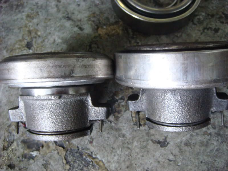

the one on the right is SR sleeve, the one on the left is !@#&*% sleeve thenismoshop sold me promising it would be the correct one. It is NOT! IT IS SHORTER! This is the reason why I could not disengage my f*cking gear!
The wrong sleeve is similar/same to a KA sleeve. Here is a picture when I compare it to my KA sleeve w/ KA TOB:

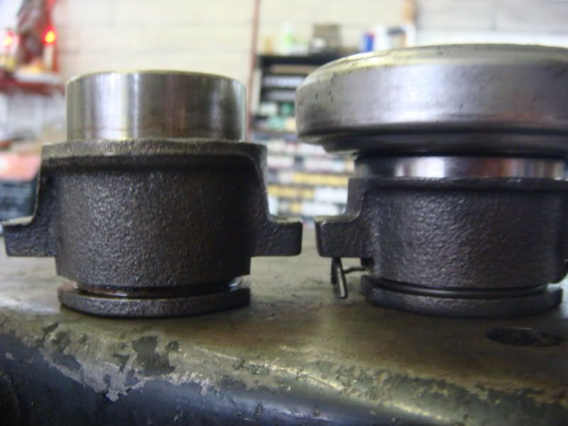

You can see the SR TOB sitting on the wrong sleeve on the left vs the KA sleeve w/ KA TOB

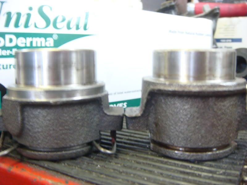

This is a better comparison pic. The left is SR sleeve, the right is the wrong sleeve (from thenismoshop) w/ SR TOB. The SR sleeve could add ~3mm in length/thickness, which KA TOB is ~3mm taller than SR TOB

KA TOB = Z32 TOB
many people say KA sleeve + Z32 TOB substitute SR sleeve + SR TOB is true
fact: You are near impossible to buy SR sleeve anywhere in the state.
Since KA/Z32 TOB is the same, you can totally replace your SR sleeve + SR TOB with KA sleeve + KA TOB. They are the same length/thickness

To add even more complexity to the mess:
Left: Original 1996 KA Sleeve with new KA TOB
Right: New KA Sleeve (for a 97) with 350z TOB
And yes it's pressed on all the way:

Originally Posted by theslows13 View Post
codyace, whats the benefit/etc of the 350z equipt?
To be quite honest, the main thing that appealed to me was that it was in stock at the dealer, and it literally matched up perfectly (in regard to contact area) to the KA one I've been using.
So ultimately there is no benefit that I can really say, other than availability. Construction wise, and that sort, they are the same, obviously the KA has a thicker body versus the Z33 one, but that's about it. I won't know how it works until end of this month hehe.
