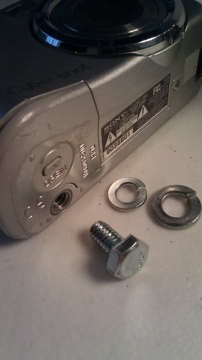

buy a bolt that will fit into the tripod hole of the camera. i used washers to make it stay intact.

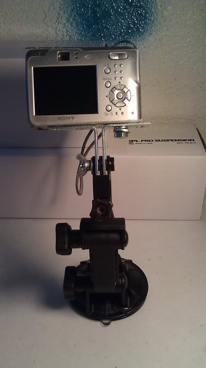

attach the camera as seen below.

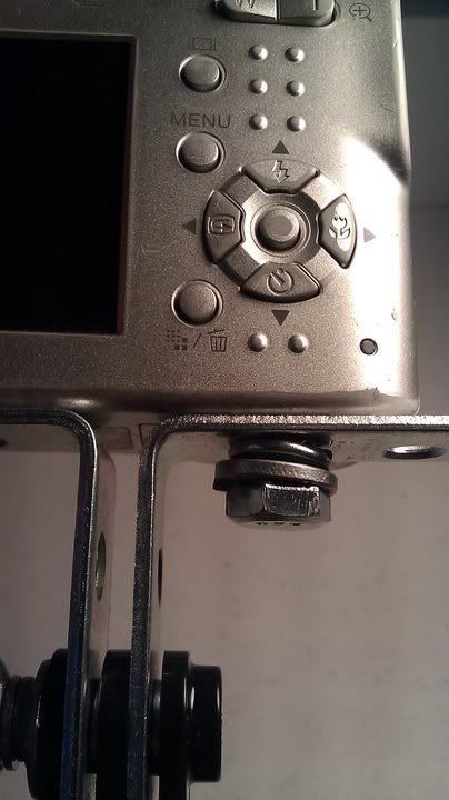

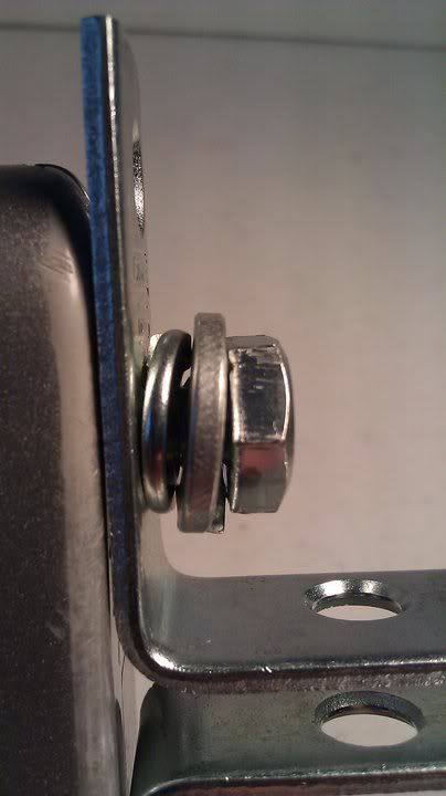

insert the hex bolt as seen here, it should line up perfectly in place.
now add the door brackets along with washers in between the plastic bracket.
its important to do so because this creates a stronger base for the camera.
lastly, add the wing nut to the other side of the hex bolt and it is now complete.
