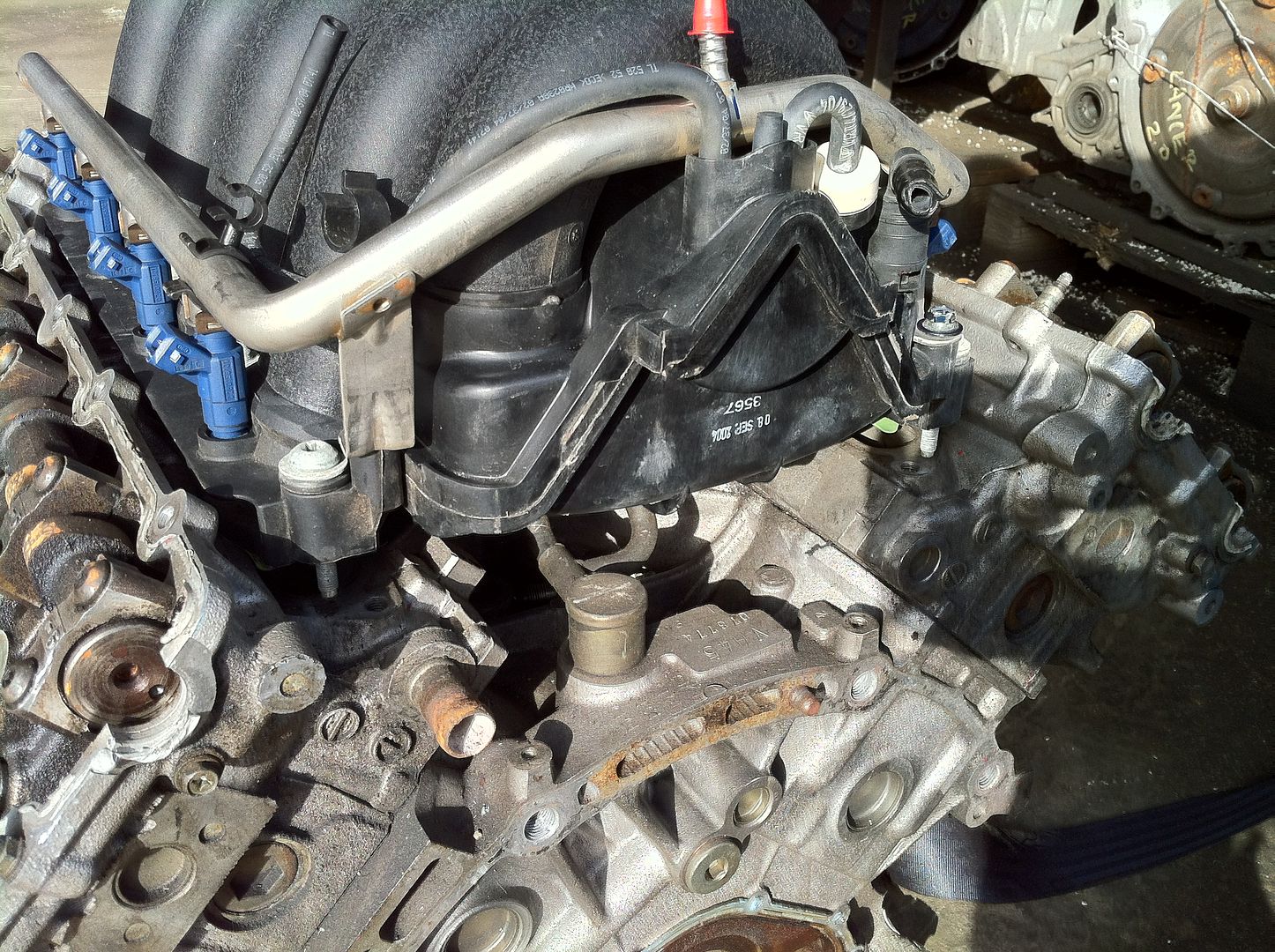

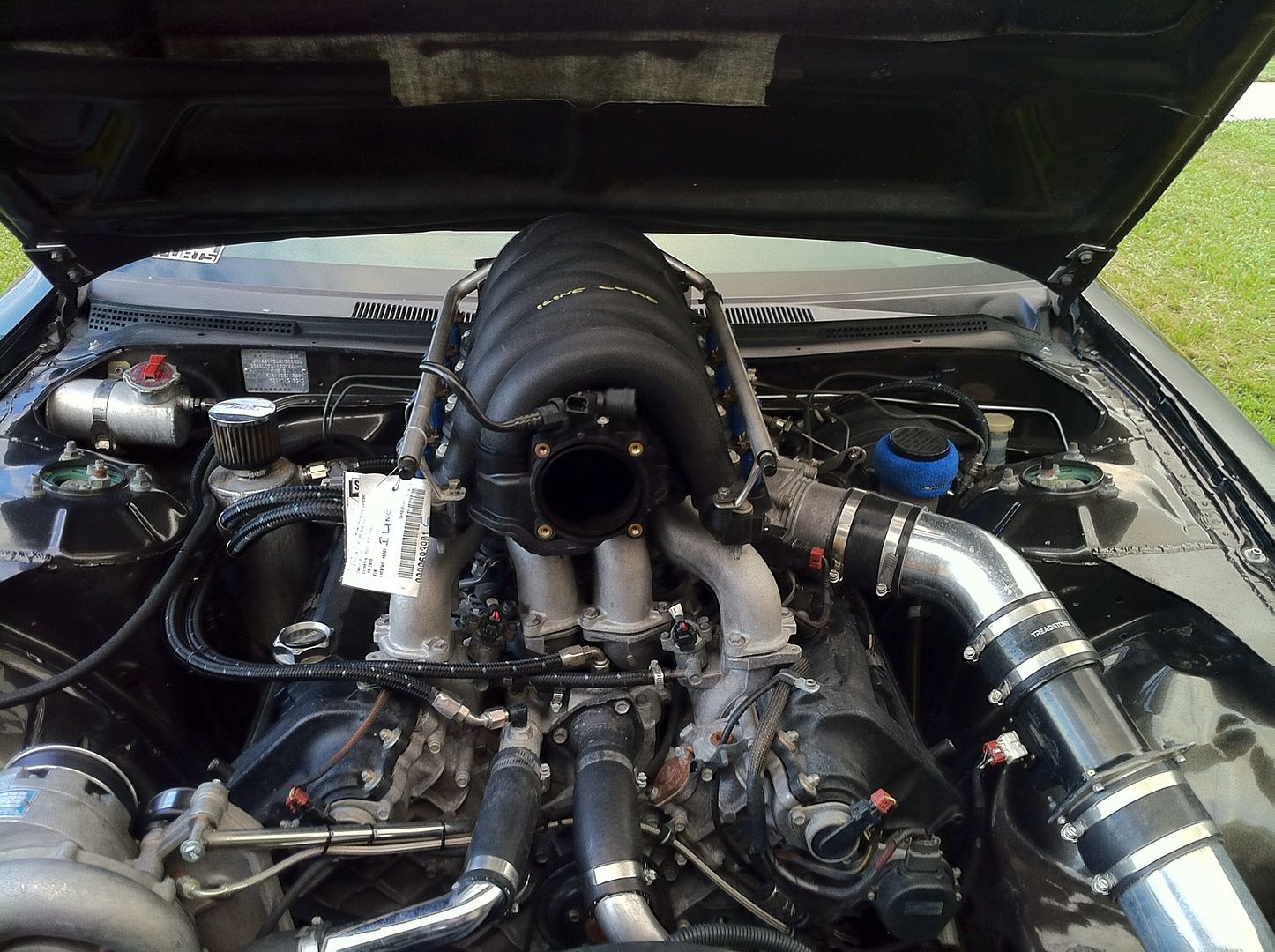

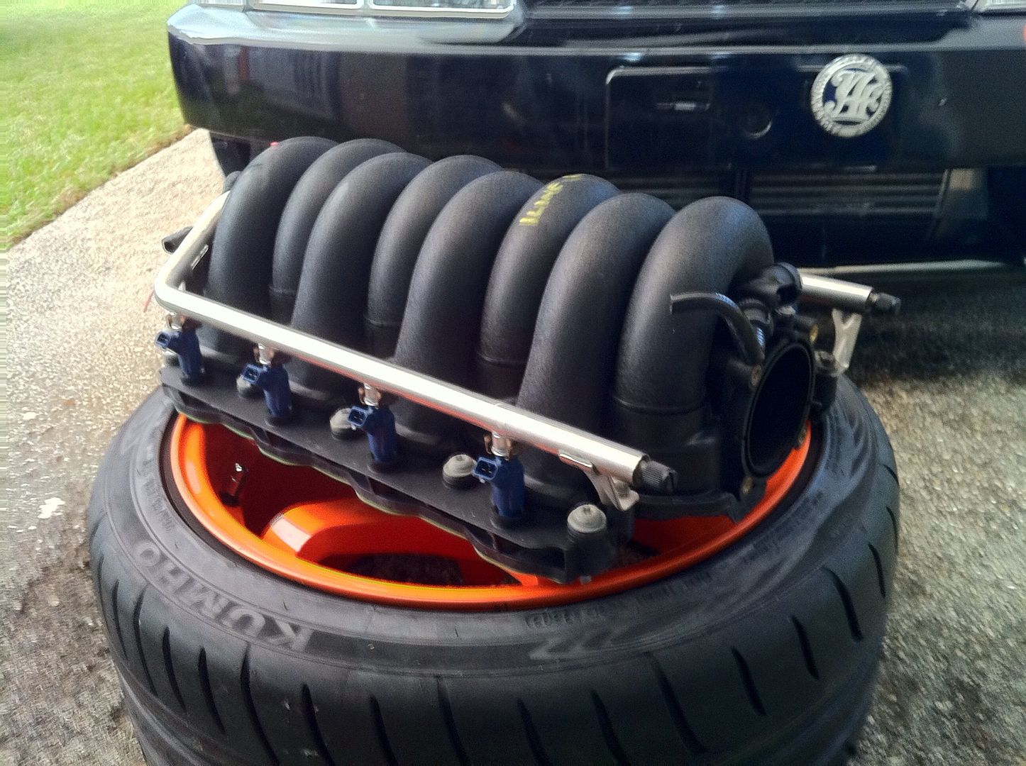

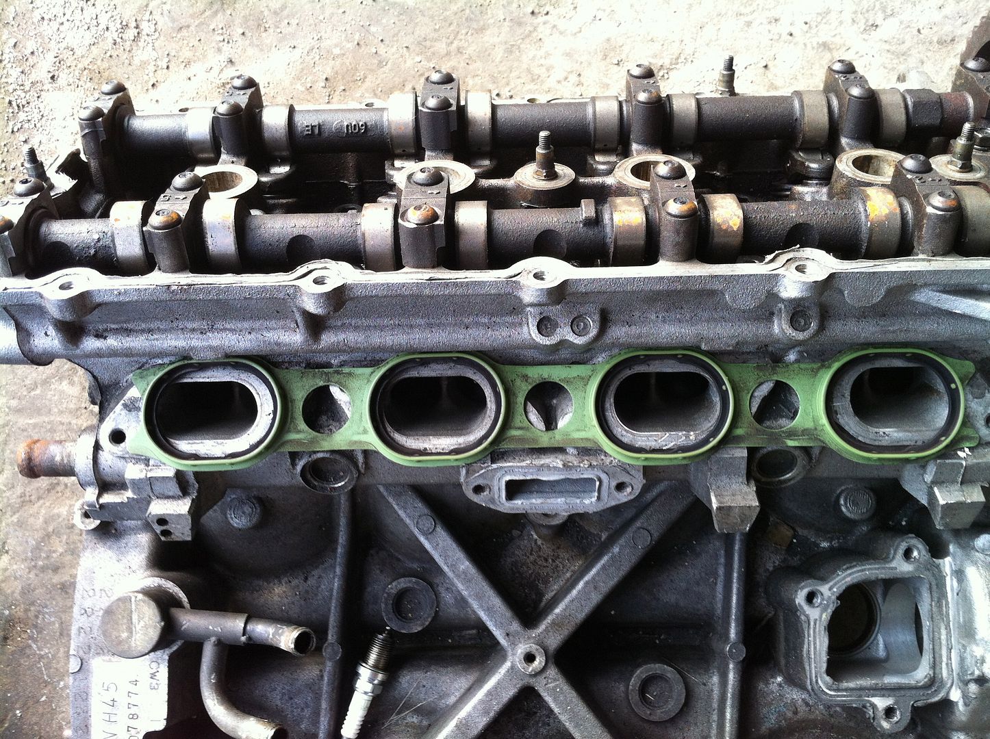

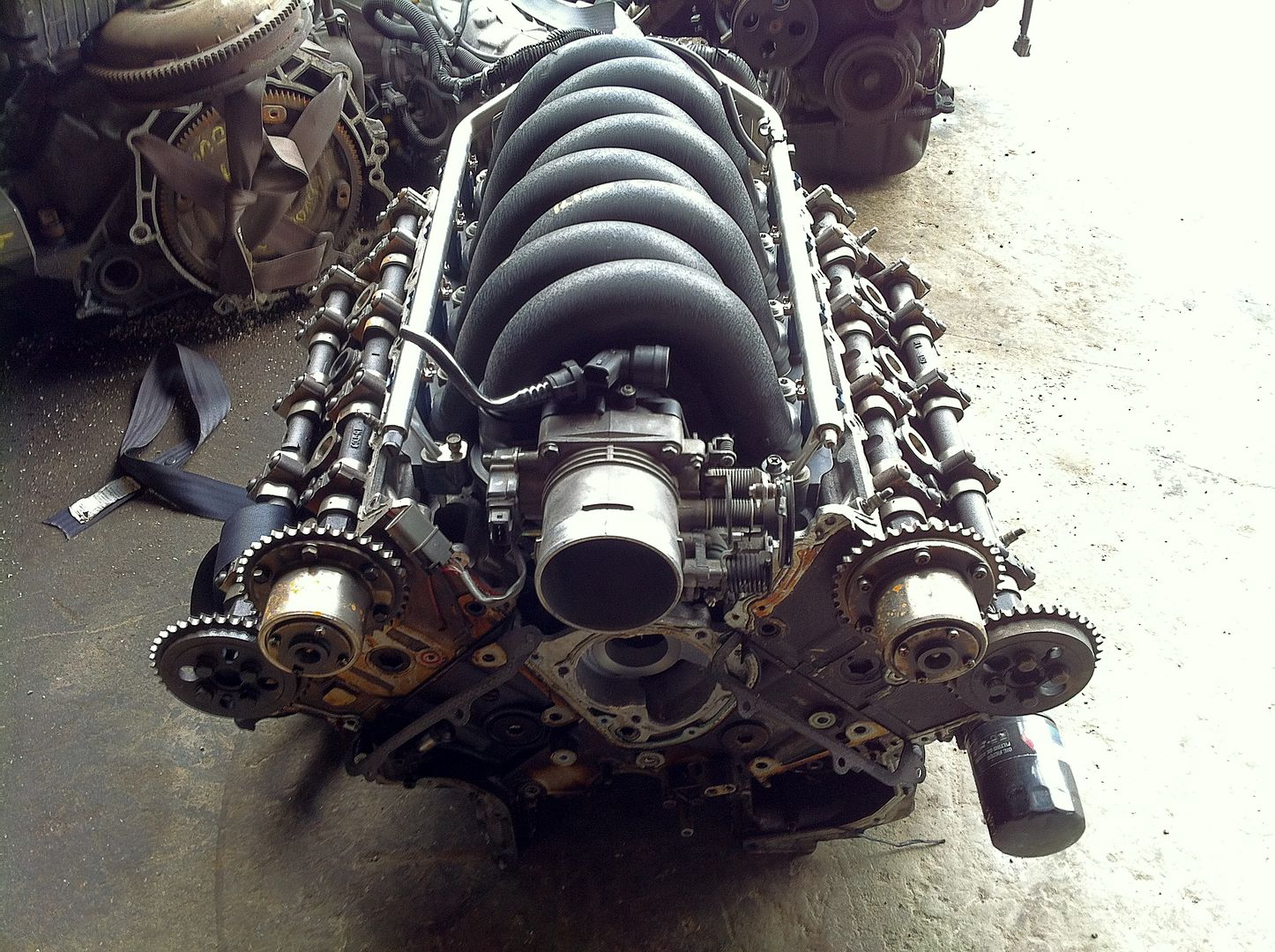

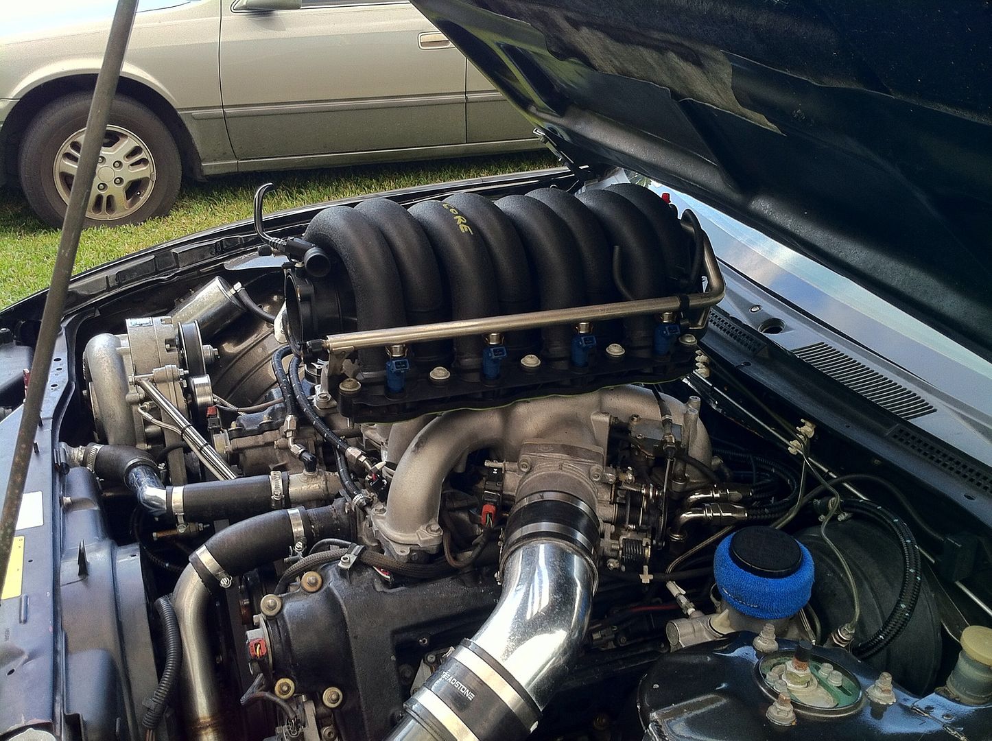

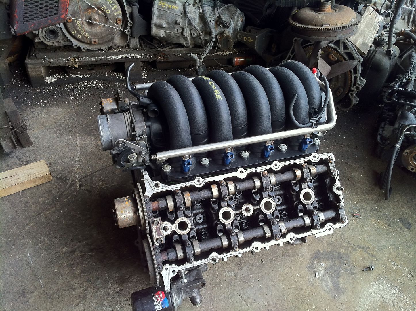

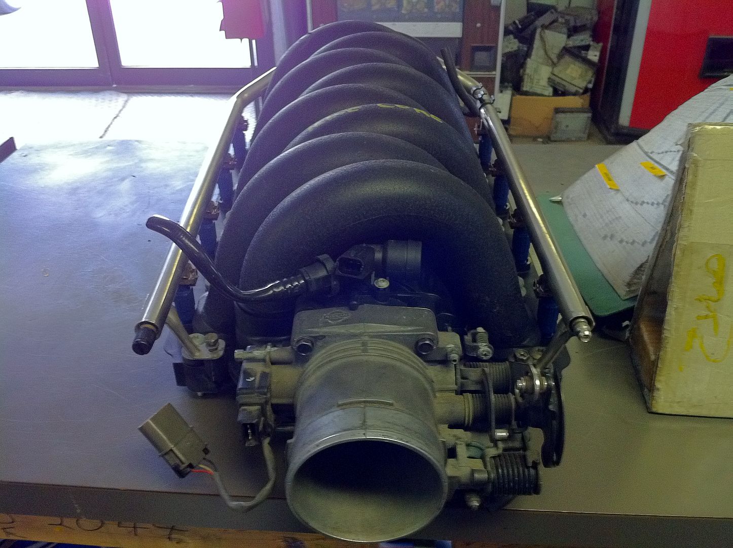

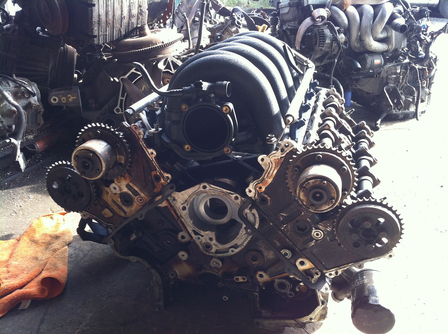

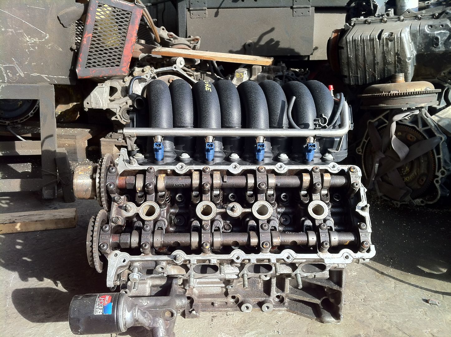

Well i decided i had enough of the stock intake manifold and heard and saw some rumors and photos so i decided i would experiment, just got the intake manifold it comes from a 4.5l 2005 porsche cayenne, it came complete with fuel rails and injectors. It looks boss.
From preliminary measurements everything lines up port wise except the bolts obviously.
I only see two issues so far.
1. Its taller than i thought it would be.
2. Its gonna interfere with the factory thermostat housing.
My tentative plans are to lower it as much as possible and if possible drill erectly into the heads or run a small spacer less than 1 inch, also to remove the factory cooling system and go to electric water pump with the inlets and outlets coming out through the back.
Anyway enough of my banter onto the pictures....

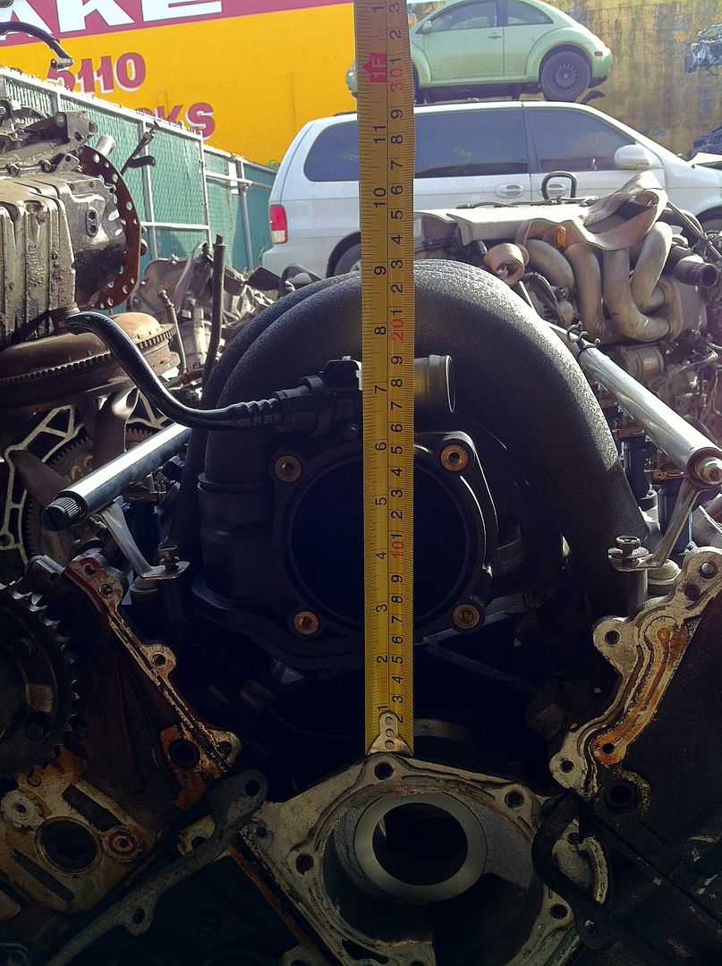

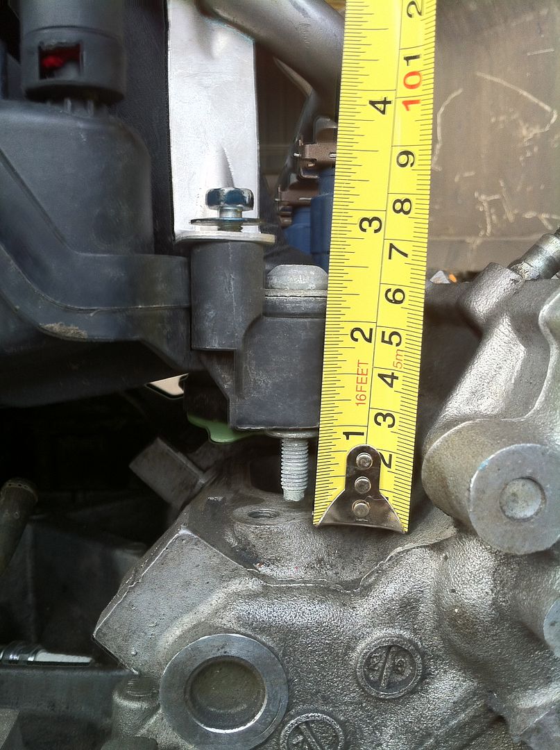

well got to mock it up today... coolant lines are a non issue as it will be high enough ultimately..
Heres some pics and measurements.
overall it will be 1.5 to 1 3/4 inches lower than the stock manifold
spacer will be 1.25 to 1.5 inches
heres the problem, it lines up a little worse than i thought so it may need some massaging.
the stock throttle Vh45de body bolts up after a little filing of the bolt holes, and I'm talking slight filing here.
