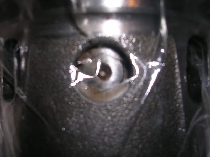

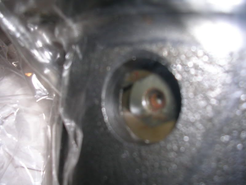

i checked my diff out and the shape of the pressure rings looks like a diamond shape:
i guess its a 2 way...

yup... 2 way! thats good!!
I just rebuilt mine after 15 years of service
nismo 2ways are great!
