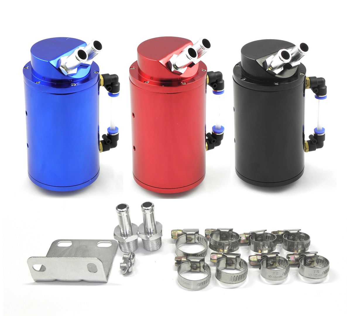

I need to establish a couple of things for my build, im trying to keep the engine bay as empty as possible so im planning on hiding things out of sight.
anyway...
The power steering reseviour;
Does this have to be at a certain height in relation to the pump or can it go anywhere? also could i use a generic alloy catch can instead?

I was thinking of using this upside down, reckon it would be ok?

I would think the return would have to be relocated to the top on that reservoir.
I had to do something similar because of tubs. I got a reservoir from ebay, and had it cut to fit. It will be placed in the corner by the brake and clutch masters. Since you are from the UK, that area will not have the master cylinders, so you should have no trouble fitting something in there.

Yeah since I tubbed my arches I can't put it back where it was and I want it to look nice too, I may have to chop a catch can up like you have^
Doesnt anywhere sell billet/alloy/polished pas res's?

Chase Bay's does. They've also learned, the hard way, about how the returning ATF comes back to the reservoir with some intensity. You'll need to internally baffle the reservoir. Check out the stock reservoir, it doesn't need to come back into the top, it needs to be slowed down and have room to de-aerate. I would definitely mount it higher than the pump, starving the pump will kill it. I'm not confident that clear tubing and push-lock fittings on that catch tank can handle the heat.
Here is the Chase Bay's one I have but I've added a bracket to it b/c I don't like the "clamp on" style it came with. I'm also tubed.
The coolant overflow isn't under pressure, as it vents to atmosphere, but it needs to have a bottom pick up since it draws liquid into the system as well as provides an overflow out.
