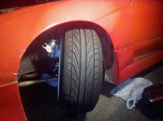

well i figured id update this. i ended up picking up some driftspeed knuckles. these knuckles with 2 small tie rod spacers, one on each side and cut off bump stops are giving me some pretty gnarley angle. unfortunately i am hitting my tension rods so i picked up some s14 flca that i am going to modify how the tension rod bolts up and notch them and see how that goes.
but ya on the steet they act totally fine. the atio is changed a little it seems but it is actually nicer.
i drove HTM with these knuckles and honestly the only times i spun it was because i was just throwing the car unbelievably far. it really is hard to spin out now. and mid drift control is awesome.
overall im super stoked on them. definately woth the 250$ i spent on them
also after the abuse i put them through at the track im not worried at all about the durability on them fo street driving.
so ya heres a pic of the angle i get now ill hopefully have some actions shots once the footage from the last event comes out
