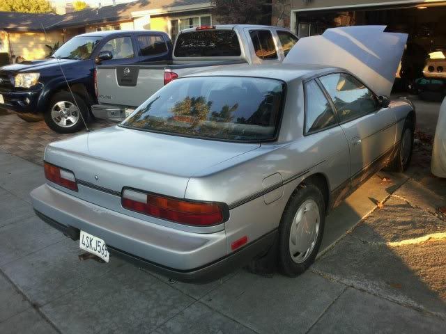

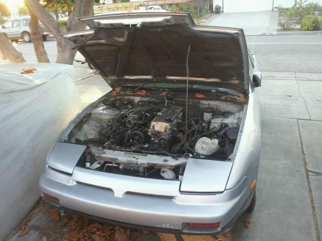

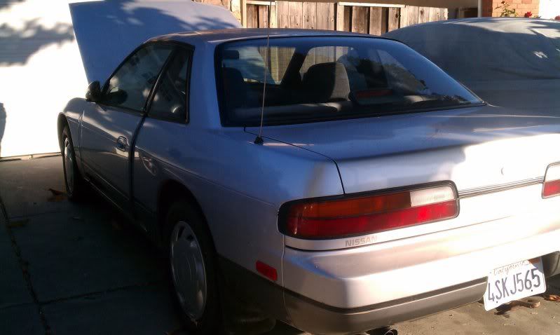

hear are sum pics enjoy
44,xxx mils on the motor

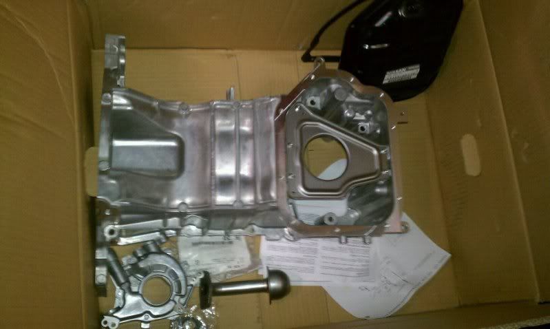

the only thing is that the car was in a car crash so the oil pan and the oil receiver was damage but that's nothing for what i got it for i got the ecm ,tranny , engine wiring harness and the vq for free lol so it was a deal

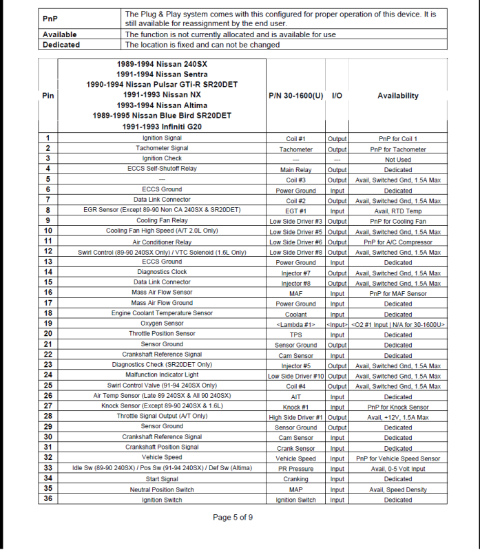

Hay whats up guys having troubles finding the functions of the plugs from the 240 harness i know where they go on the 240 the ones on the left go to the shock tower and the ones on the right go to the inside by the glove box
need to know the names and functions where they go thanks for your help

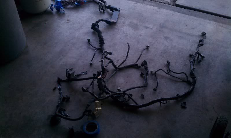

hear is the vq harness

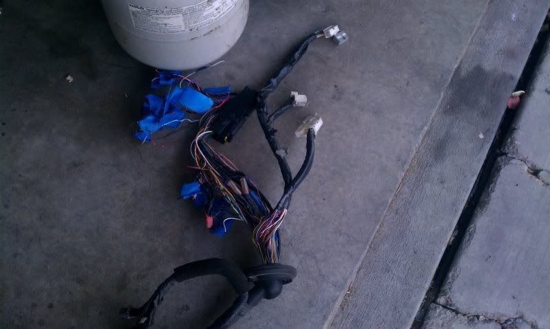

ive began cutting and labeling the wires of the vq wire harness

ok found out what they are hear is the diagram
very important to the swap !
Brown Plug, 8 pin, 3 pins empty, cut and rewire as necessary
Red/Black - ECU relay ground pin controlled by pin 4 of ECU, connect to ground pin of ECU relay
Brown - Power source for all sensors, connect to switched power
Green/Yellow - AC relay, not needed
Black/Pink - fuel pump relay ground pin controlled by pin 104 of ECU, connect to ground pin of fuel pump relay
Green/Orange - park/neutral position to pin 35, not needed
Small Grey Plug, 6 pin, 2 pins empty, not needed
Black - ground, not needed
Blue/Yellow - exhaust temp sensor signal to pin 26 of ECU, not needed
Blue/Green - AC power, not needed
Blue/Red - FICD ground, not needed
Big Grey Plug, 8 pin, 2 pins empty, cut off and rewire as needed
Blue/Red - coil pack power, connect to switched power
Black/Red - ingition power, connect to switched power
Blue/Yellow - AAC valve power, connect to switched power
Black/White - ECU power to pin 47 and 38 of ECU, connect to switched power
Blue/Green - power from the AC relay, power goes to the AC compressor and the FICD, not needed
Red - ECU Backup power to pins 46 and 109 of ECU, connect to constant power
Dash Connector, 15-pin white plug next to the ECU
Black - ground for CONSULT, not needed
Green/White - Clock (CLK) synchronization pin for CONSULT, not needed
Green - Transmit (TX) pin for CONSULT, not needed
Red/White - Fuel Pressure Control Module, not needed
Blue/Black - Thermal Transmitter for OEM coolant temp gauge, not needed
Yellow/Red - Tach signal for OEM tach, not needed
Green/Red - Clock signal for CONSULT, not needed
Orange/Black - exhaust temp warning lamp, not needed
Green/Black - Receive (RX) pin for CONSULT, not needed
Blue/Green - Thermistor Control Amplifier, not needed
Orange - Start Signal, connect to start signal from ignition switch
Blue/White - Intake Air Temperature Sensor, not needed
Yellow/Green - Vehicle Speed Sensor (VSS) signal from speedometer, not needed

ok guys so o got sum parts for my swap up date !!
hear are sum of the parts i got headers,fuel railes , 3 inch electric cut out also pulleys and a push start button......:naughty d:

ej1bullet
Join Date: Jul 2011
Location: san jose
Posts: 42
ej1bullet is an unknown quantity at this point
got sum new parts in
ej1bullet is offline   Reply With Quote

240sxr is an unknown quantity at this point
nice job,I have a VQ also...so sweet and powerful engines
you should return that regular VQ35 oil pump and put a rev up oil(05-06) pump while you're at it
and those headers are not for a VQ
240sxr is offline   Reply With Quote
there is two sets of headers in that pic
which one isn't for the VQ other than the obvious v8 headers?
