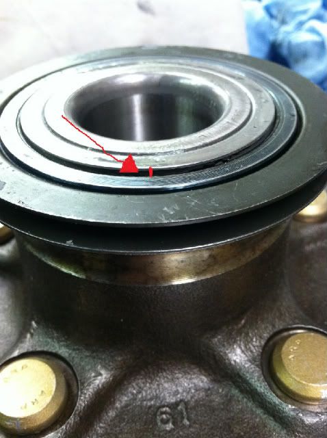

I regreased my s14 front hubs but couldn't get the shield thing in the back of the hubs to pop back on completely... I can press it down no problem but it just pops back up even after a good torquing... Did you have this problem?
Edit -
Just checked my front hubs and they do have some play like in your video. Definitely get some wheel bearing grease in there.
Also took a pic of "shield" I was talking about. I know they didn't have this gap before I took them apart and the shields kinda popped out of place when I was taking them apart.... I was expecting them to pop back into place but now they are just kinda sitting there.
