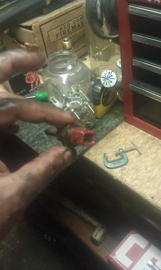

So I fixed the thermostat but when I was replacing the coolant temp sensor, the 'vagina' part on the wiring harness broke off.... and fell somewhere in my engine bay..
Does anyone have the plug that connects to the coolant temp sensor? I need one now that the old one broke, I'm assuming I need to re solder the wiring to make it work

Tbh, your best bet on getting a new connector is going to the junkyard and pulling one off of a car there - or find someone doing a swap and asking them if they're willing to cut off the plug.

Maybe your sensor was fine and it was the wirings that was fubard.
But here ya go
| pi | wiring-connectors | gm | pigtails | female | ACDelco TechConnect

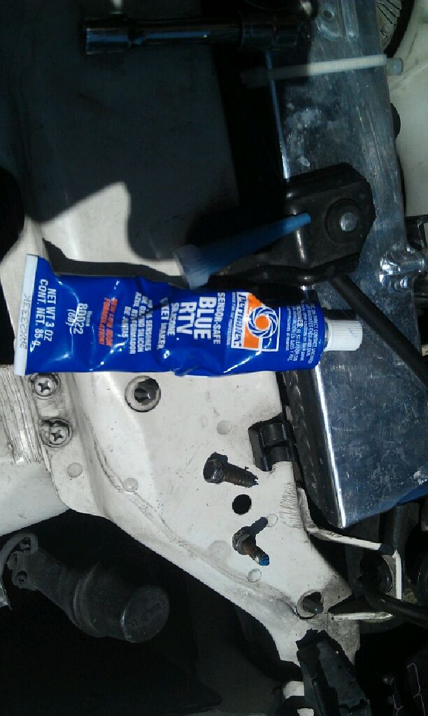

Just use RTV for a gasket. If you can run a nice 1/8" bead of RTV around thermostat housing and then go full circle around the thru holes. or do like me and smudge it on all sloppy then smooth it out .
Also make sure the thermostat doesnt slip out of its little groove when installing the housing, it should be easy to tell if it does. But that will forsure cause it to leak as well.

Don't just "slab it on there".
Do as I said in my previous post. To much RTV and you can block the jiggle valve.

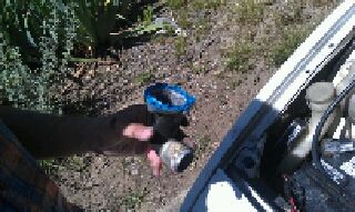

Ok, ill be attempting this today, I'll take pictures since you and others have been kind enough to help a guy out. Might as well humor you.

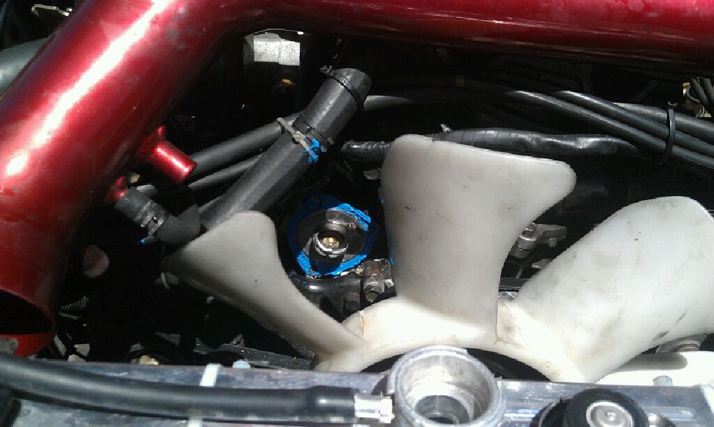

Really happy because I was able to install an Accessory fan. The temp sits right below medium now.

looks like the jiggle valve is on 2'o clock. it suppose to face on top, the 12' o clock position...
you mean the actual thermostat inside the housing? Does it really matter? because I heard you can even drive w/o one.

The jiggle valve should be at 12'oclock
Squeeze RTV from the bottom
The RTV nozzle cap is used to run a bead, so you don't have to put your finger in it.
If it runs and stays cool with it where its at you are probably fine, but it should be in the 12 O clock position.
If its on the bottom it will forsure cause problems, just off to the right a little though, you might be okay.
But here ya go
I need the part number for the coolant temp sensor female part.
does anyone know it?
