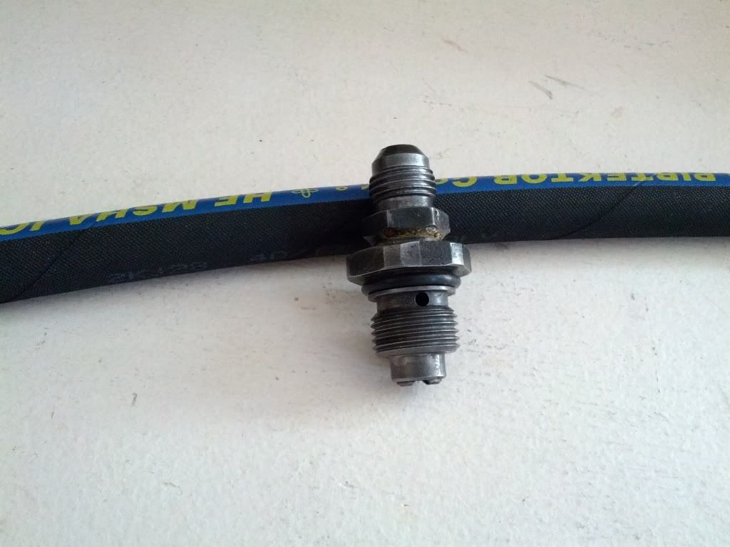

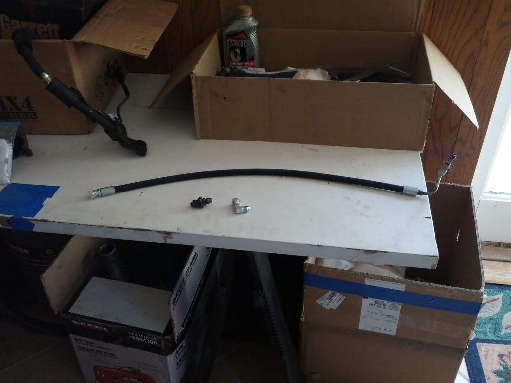

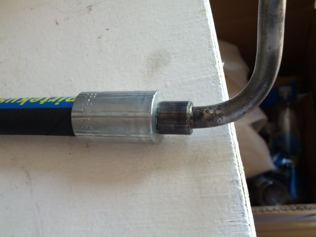

Seems like bc. made his own lines retaining the stock fittings..
Originally Posted by bc. View Post
Got my line done. It deletes any need for a banjo fitting.
This was the original banjo stud that came out of the pump. It was cut in half to remove the stock banjo connection but will retain all functionality of the pressure reducing assembly inside the pump.
Here is the side that goes into the rack. All 'welded' connections were actually done with silver solder.
Sorry the last pic is blurry, but you get the idea. The hardline was cut and soldered to a hose barb. The o-rings were also replaced.
2iv0 sx is offline   Reply With Quote

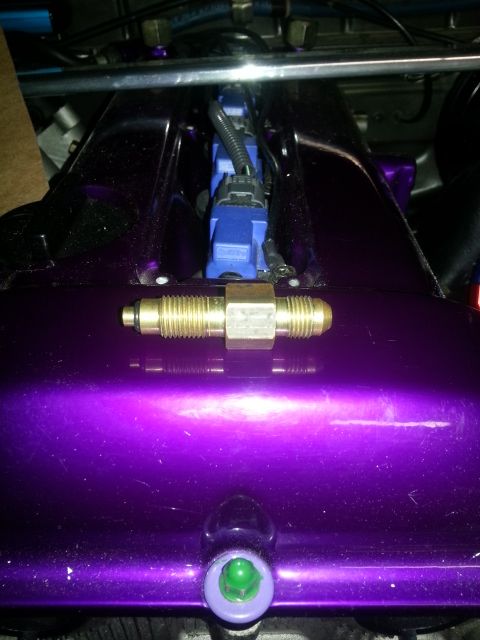

for the rack side high-pressure fitting
i ended up having a custom fitting made out of brass for this, basically i copied the dimensions of the hard line on one end and a -6AN on the other, i will try to get pics when i get home.
