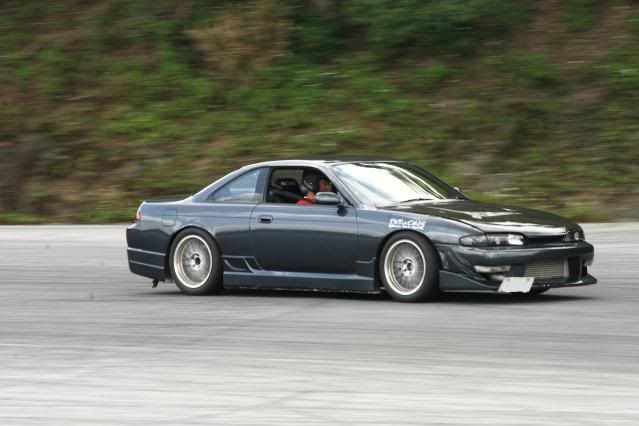

Originally Posted by flyguybry86 View Post
Would a 17x9 +12 fit on an s14 with a stance gr+ coilovers fit? The car is lowered 4 inches. What tires should it get? The rims also come in 17x9 +22 and 17x9 +0 and +22. What rims and tires would fit best without pulling my fenders and the least amount of camber?
Without pulling your fenders...9j +22.
This was my grip setup: 17x9 +22 with 255/40-17 NT01
