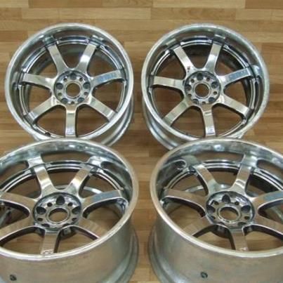

is it possible to fit 18x9 -3 18x10 -3 on stock s14 fenders?do i need a pull?
would like to run these!!
thanks for any help!

For an s13 you will need a lot of camber and stretch unless you run a lot of pull

18x9 -3 no pull just roll and 215 or 205 tire + camber maybe, 18x10 -3 you'll need to pull the quarter panel

All depends on tire. Are you looking to run fat tires or stretch tires?
For stretch-
Front just roll with 215/40 around -2.5 camber
Rear you can just roll with 225/40 with -5 camber
or small pull and run -3
btw are you buying those wheels from CZ wheels?

^ thanks guys
I dont mind a small stretch just dont want to pull the fenders.
Im thinking of buying them from cz wheels, have you delt with them before?

I haven't personally delt with them but a local has.He got screwed over on custom built wheels. Rim was leaking air on the seem, powder coated faces where scratched, the brand new lips he paid for where also scratched heavily and to top it off, at the last minute the shipping price went up. Also his buddy ordered wheels in April and to this day have no pictures of his rim but already paid in full. If your going to buy wheels from them i would go in person and check it out.
Know lets get back to fitting.
If you want no pull run 225/35 and run about -4 camber. You should be fine.
