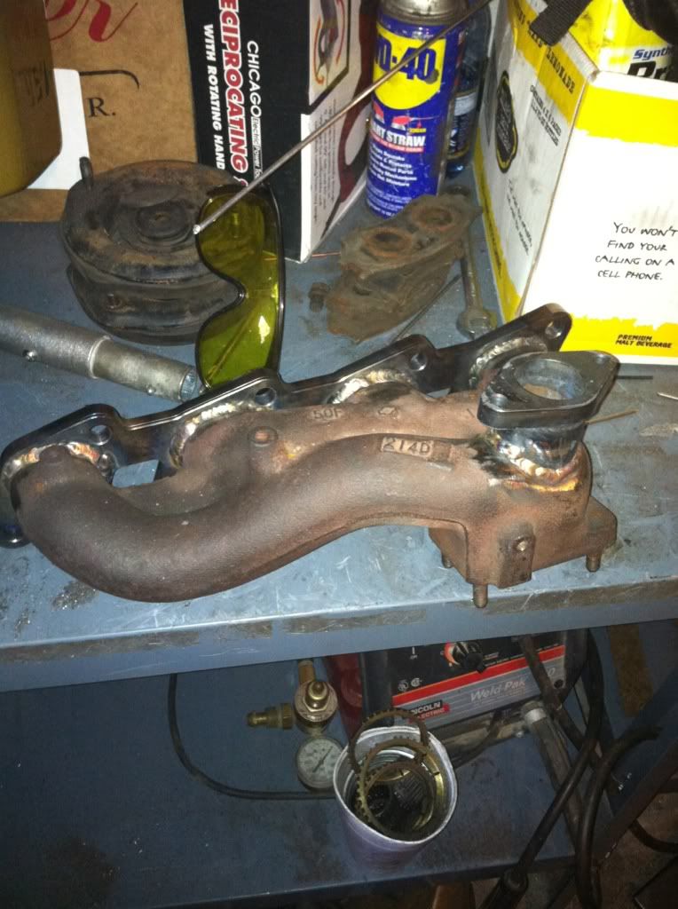

I got mine in today! .82 T 25 Plus housing with 2.5" V-Band on a converted to KA - SR manifold. I hope to test fit it to the car next weekend I hope! It took 2 weeks for me to get it.
Pics:
SR to KA Manifold Finished:
Package:
Front Cover:
Rear housing:
Rear V-Band shot:
Test Fit:
Its got lots of clearance with the stock turbo:
Cant wait to get that puppy going!

Old 11-16-2012, 07:50 PM   #449
huffandpuff00
huffandpuff00's Avatar
Location: oregon
Posts: 835
huffandpuff00 has a spectacular aura abouthuffandpuff00 has a spectacular aura abouthuffandpuff00 has a spectacular aura abouthuffandpuff00 has a spectacular aura abouthuffandpuff00 has a spectacular aura abouthuffandpuff00 has a spectacular aura about
new ATP t25 plus .63 housing all welded up. Should be a considerable amount more of clearance for the WG given how low this flange is placed compared to my other ATP .72 housing. Also Alex from PSI, being the amazing welder he is, welded the inside of the flange to insure the weight of the WG wouldn't cause any problems down the road. Still deciding if i want to go 2863 or 67...
huffandpuff00 is offline   Reply With Quote
Old 11-16-2012, 08:11 PM   #450
huffandpuff00
Location: oregon
Posts: 835
@240sxfan6882
I don't know if you saw that atp makes a flange that fits on the t25 plus housing and excepts 3" exhaust pipe. Because we are still bottom mount i know theres not to much room between the turbo and firewall, so if the 2.5 to 3" flange adapter doesn't work out, check these out.
