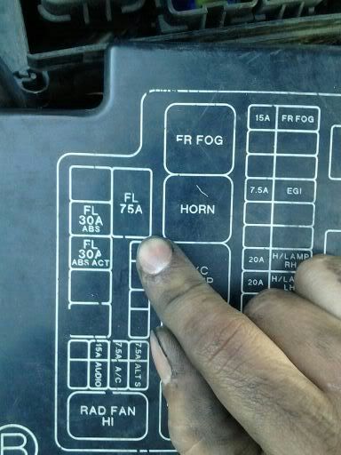

ardeine
Join Date: Feb 2012
Location: santa clara, ca
Posts: 22
ardeine is an unknown quantity at this point
heres the pic of what fuse is popped. can this cause my cluster to not work?

Pretty sure its your first code. Recheck that shit bruh. As far as the fuses go, I'm str8 s13. I do know a big 75 is for the alternator on the s13, irc.

i have a feeling it could be my aicv since thats one of the codes. and that fuse i went to the junkyard and got that and spares. yes i believe its for the alternator also. ill check it out tomorrow after work. thanks for the help friends!
