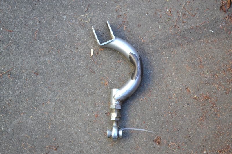

When I did the set for my friends drift car I used the adjusters from a broken set of SPL arms. Also used the heims, and spacers. Tubing was 1-1/2 x .120 wall DOM. The yolks are 3/16" cold rolled.
One of the reasons I chose to make them instead of buying new was the setting that we run I was not comfortable with the amount of adjustment that off the shelf ones gave us.

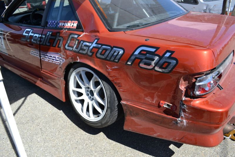

What happens when you get hit with an SC300
So make sure and build them strong
