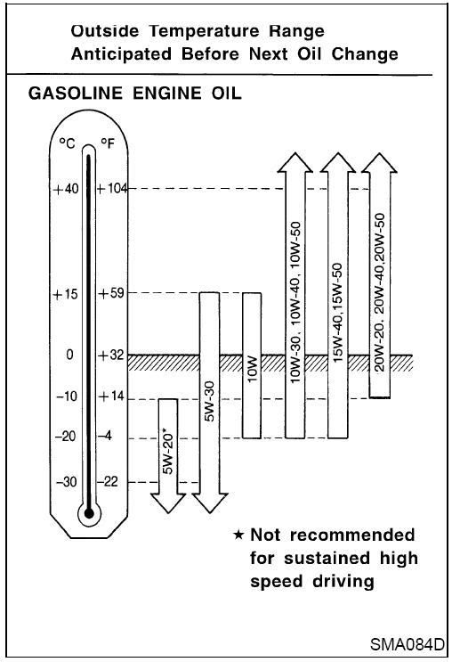

I found that chart for temp vs oil weight. It was 30C out yesterday so if I'm reading the chart correctly I should be running at least 10-40.
Is there any way to check for a bad oil pump, other than obviously pressure? And what cause's an oil pump to go bad besides wear?

That chart applies to standard engines used as commuters. You can find it on numerous car driver manual.
