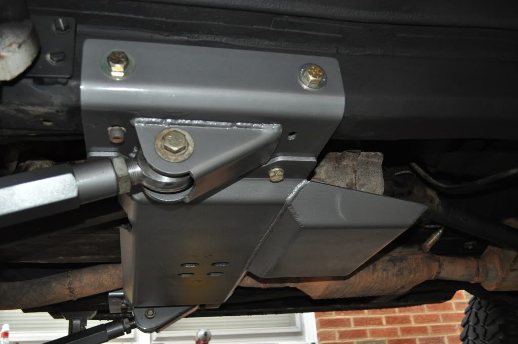

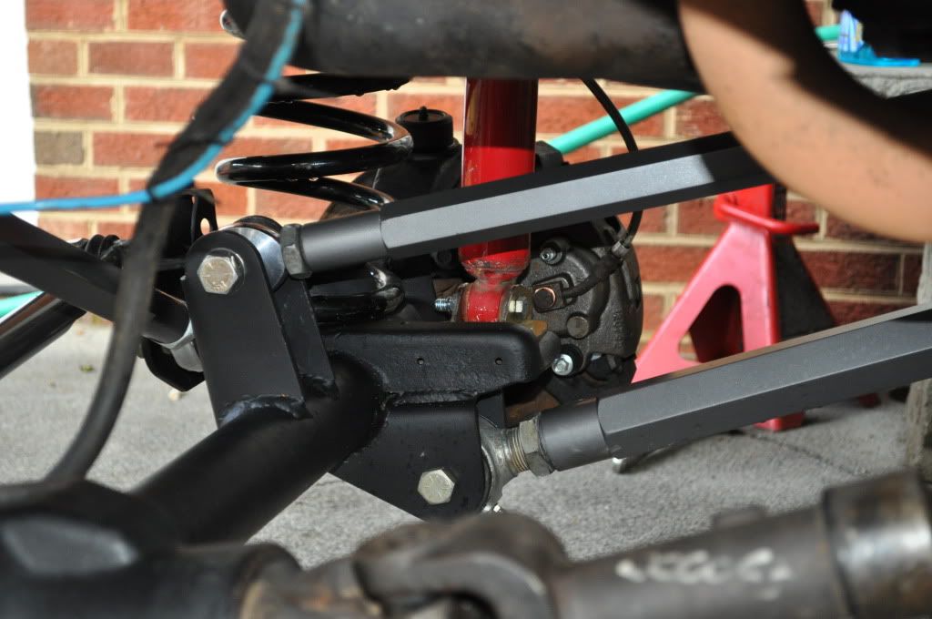

Actually, Ruffstuff and Ballistic Heims are all load tested.. I had great dealings with Ruffstuff over the years, running them on my Jeep.
I never had any problems with them, and they have great service...
