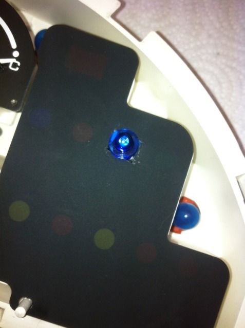

Originally Posted by ki_JDM_ds View Post

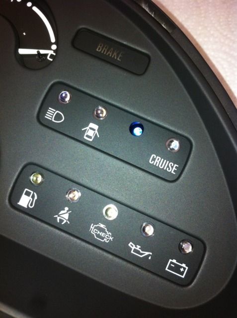

I did this a few years ago. I didn't like where people put there aftermarket alarm LED warning lights and wanted to come up with my own solution. It was inspired by OEM alarm LED placement.
I used my HUD gauge cluster but it should work the same on an analog one.

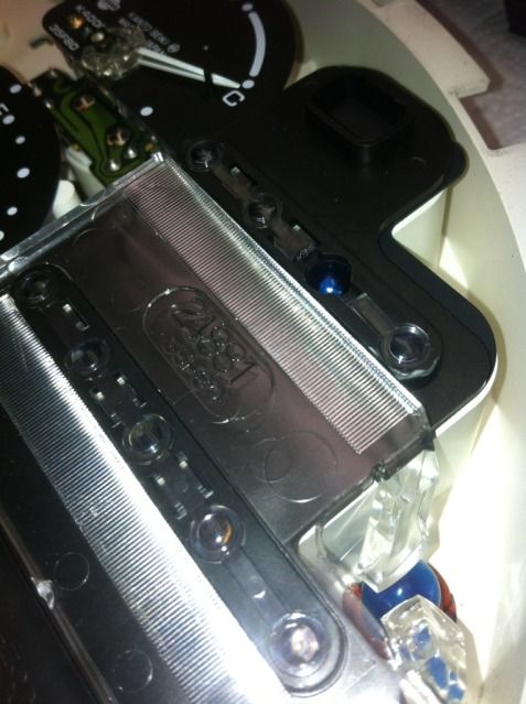

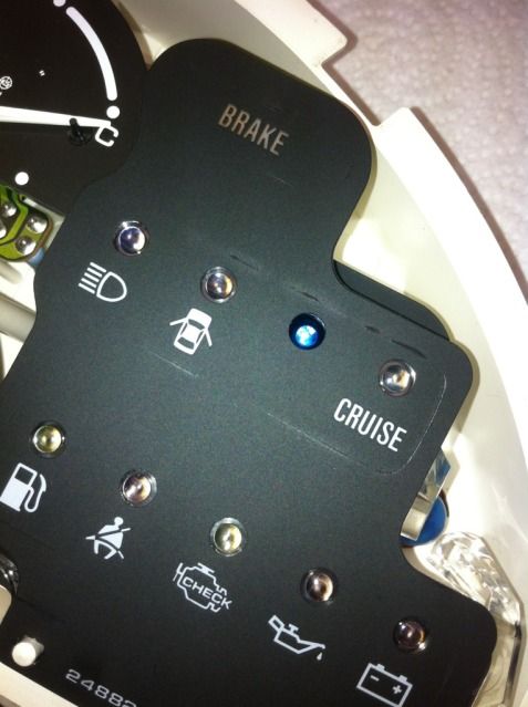

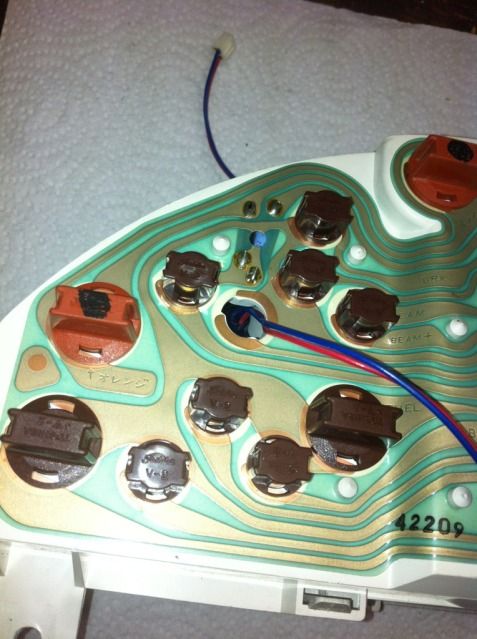

First pick a spot. Preferably an unused warning light spot. Trim a hole big enough for the wiring to fit through.

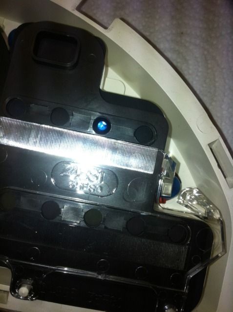

Next trim the clear "domes" to make the LED fit flush.
There is no cutting required after this. The warning light panel fits just like it should.
I then pulled the wires through the empty bulb hole and ran them behind my dash.

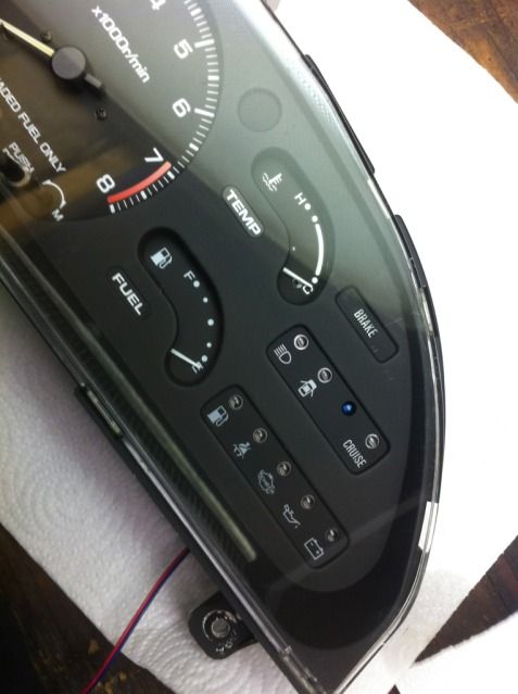

Here is the finished product.
When activated the light will illuminate the entire cabin at night and it looks factory.
