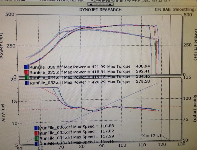

very interested in seeing this threw I have a fully built sr with a gt3076r made 420 on 91 going e85 in a few months looking at 600 but I might want to run this turbo really want to see dyno lol

Wanted to share my results. I've been running this setup for about a year now but finally got it on a Dyno.
Wiesco 9.5:1 87mm pistons
Eagle H beam rods
Acl Race bearings
Cometic Head Gasket
ARP Head Studs
BC 272 Cams, Springs, and Ti Retainers
Circuit Sports Cam Gears
Garrett GTX2867r .64
Custom intake manifold
PBM High Mount Intercooler
Power FC D-Jetro
LS2 Coils
Deatsch Werks 810cc injectors
Sard FPR
Dual Walbro 255lph fuel pumps
Tuned on E85 at 2 bar 422whp 409wtq
Member is offline   Reply With Quote

Those nummbers seams way to low for that fuel and boost pressure.
I ran 415 WHP on 1,85 bar with 95 RON with the GTX2867, and that was on som way milder cams aswell.
How mutch timming are you running with the E85 at those boost pressures!?
Are you sure those injectors are 810cc?
Theres no way they will support 420 WHP on E85.

19 degrees at full boost. And it was spinning on the Dyno. It picked up 30lb/ft just by tightening the straps. So I'm thinking the power should be a little higher. However I know the exhaust housing is a huge factor. The torque is what was pretty impressive to me. Also I don't know if it was hitting full boost on the dyno.
Yeah they are 810's I'm running 2 255's in series and base pressure is 75 psi. At full boost they are flowing almost 1200cc/min. According to Deatschwerks pressure/flow chart

I also find those numbers to be a but low for E85. You need more timing for starters. E85 requires a lot of timing.
Looks like your AFR is around 12.8-13 if that's correct you should richen it up. That's too lean for E85.
Not sure why your spinning on the dyno with that little hp unless you have some stupid camber issue.

The wide band in the car reads between 10.8-11.5 under boost. And it was definitely spinning the tires. The Dyno room smelled like rubber and it picked up 30lb/ft just from tightening the straps. It built 200lb/ft in 15mph that's a pretty big jump. And I am running 255's with .5 degree of camber in the rear. It spins 3rd from a roll no problem on the street so I totally understand it spinning on the Dyno. And I know the HP seems low for the boost level however 400+ tq is pretty impressive for a T2 flanged SR.

Does anyone else have Dyno graphs? I'm curious what other people's curves look like. I am not shooting for a high number with my tune. More looking for a broad power band. My car is used mainly for drifting and I wanted a very long hp/torque curve.

https://www.dropbox.com/s/ert7442dtx...i%201.jpg?dl=0
Thats my graph on 95 ron and 1,85 bar boost.
I am even peaking more torque the you are. But it seams to fall of at a higher rate on top of the power band.
Whats your max RPM on the dyno!?

Pulls were to 7500. The big cams help with the long flat curve. Smaller cams would probably give more of a peak. That is pretty good for Gas. What cams are you running?
