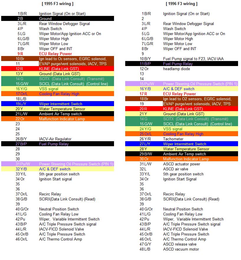

First some pics:
This is not mine, but it might be useful:
F3 plug ID, I made this by looking at an actual harness

I know this is an old thread but just wanted to point out that kingtal0n's 1995 KA24DE pinout is correct. the first pic with 1995 and 1996, side by side is incorrect because they are based on TWO different pinout counting methods. Using the pinout that kingtal0n used (ie. counting all the large pins first, before counting all the small pins) I've fixed that image here so it's not so confusing.
on the left, 1995 S14 USDM KA24 and on the right 1996 USDM KA24
http://imgur.com/KL92fhf
