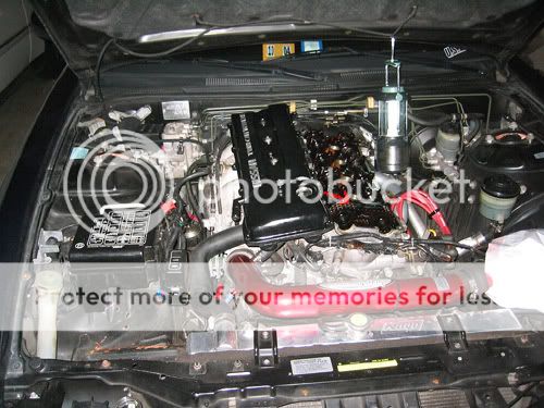

I was painting my valve cover today and when i removed my valve cover i found a piece of metal layin on top of my timing chain. it was supposed to be mounted to this thing but it broke off and now it jus sits on top of my timin chain. if it was connected they would not touch. i believe this piece of metal of supposed to keep the timin chain in place so it doesn't move anywhere. my cars been makin a rattlin noise ever since i bought the car i nvr really found out until now wat was makin the noise. i'm not sure if i should jus leave it where it is, drive w/ it out my engine, or maybe i could jus get one from someones ka (someone whos done sr swap and doesn't need their ka). wat should i do?
The location of the piece of metal
This is me holdin the piece from the chain

REmove it... that would be what I would do

Throw it away. Don't worry about replacement, because Nissan realized it's a superfluous piece, and deleted it from their parts manifest. Just throw it away and move on.

the same thing happend to me when i opened my valve cover!! i went to the nissan dealer and they to just remove cause i dont need it anymore.

yeah i just took mine off last weekend, got rid of some of the rattling too. the underside of mine was pretty scratched up, but thats a pretty sturdy plate, im surprised it just broke.

upper timing chain guide... that sound must've been pissing you guys off, no? yeah just remove it. there's another one that can cause rattling too. check the FAQ section on timing chain guide rattle... the post was by 'misnomer.'

I thought my guide had broken last year when I heard the rattle. So I removed the guide and it was
still intact so it was just the lifters as I was told. My car has been running strong since then.

hrmm looks like u relocated your battery, maybe you should customize your intake to go through the passenger side instead.

Sr does have one and mine broke too. The cause of it was a bad tensioner which put slack in the chain and let it hit the guide. Take it off anyway even if it doesnt rattle yet. Once it does rattle it means the chain is hitting the guide and grinding off metal shavings into your engine (not good). What causes it to break should be addressed too. Mine was a bad tensioner, but it could also be a stretched chain or low oil pressure.
