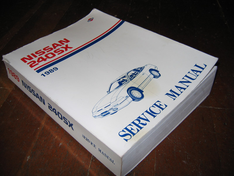

Factory Service Manual
1990 S13/SR20
Rusker is offline   Reply With Quote

Find one, and buy it. This will be the best money you spend on your car, I promise. There are version online, but nothing beats having it in book form.
